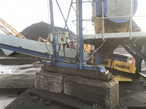

If this installation was new, would you provide 30mA RCD protection?
  • Not a job I would agree to test and inspect, it’s out of my league.
    Is it a quarry or a materials handling site? I would assume that if it is a quarry then the additional requirements for quarries and mines apply to it rather than just  BS7671 and the machinery requirements if it is just a transfer facility.

  • Since it would be classed as 'Portable Equipment Used Outdoors' then depending upon motor rating, all of the conveyors we inspect/test/connect up have to have 30ma rcd protection. Generally, this is via a plug/socket arrangement with an integral 4 pole RCD , with the socket being fed from a main control panel and it's wiring protected accordingly for the rating.
  • Yes, probably.
    I assume that the sockets are 32 A.
    411.3.3 an exception may be provided for (i) if a documented risk assessment determines that it is not necessary. (You would need to see the actual document.) The furthest left socket may have individual RCD protection. If it is intended that the other sockets are used for a fixed purpose, perhaps being provided with a view to isolation for maintenance (Table 537.4), (ii) need not apply - the equipment does not appear to be "mobile".

  • From the photo it looks like the topside of a coal mine to me.
    I see a conveyor, which looks to be on a plug and socket arrangement - surely a 400v trailing lead mandates rcd protection in any case?
    I hate to see steel, even coated steel enclosures used outside like this. The ones we find on site are generally ill-installed,and  bashed to bits, thus no maintenance of IP integrity and much ingress of all kinds of rubbish.
  • This is a dockside coal yard that sorts and grades thousands of tons for onward delivery to wholesale customers and the company’s own bagging plant. The sockets are just convenient means for connecting the conveyor motors. There is a TPN socket just outside the picture which is fitted with a 30mA RCD. This was specifically for power washing and has a notice to that effect but it got hit by a lump of coal and, although not dangerous, no longer functions. They do the power washing when the plant is idle but whilst the guy doing it has no idea of the merits of a 30mA RCD, he is cute enough to start the conveyor and use one of the motor ports.
