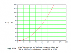

  • This graph may help to illustrate the rise of cable core temp, versus the load, assuming conduction, not convection - i.e. a square law - convection cooling improves at higher temps, as air starts to be circulated faster- this model ignores that and is correct for cables in solid media, and over estimates the high end temperature  for air or liquid cooling.
      Of course if you start at 20 or 25 degrees instead of 30, you have a bit more leeway, and the cable ratings assume a very long warm up, hours rather than seconds, so the if a breaker is going to trip it will have, long before the cable temp reaches the equilibrium value.
