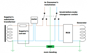

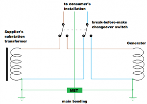

  • If it helps at all, here are some diagrams (originally done for the old Forum) for the usual layout for switched alternative local generation (the principle is the same whether it's a petrol generator, or battery and inverter, or anything else).
    The first one shows the simplest case of everything TN-S - and how the generator is configured/earthed in just the same way as the DNO supply in a nice symmetric layout. When connected to the DNO's supply (and the generator off), the DNO's electrode provides the means of earthing and the local generator's earth electrode is nothing more than one more extraneous-conductive-part. When the DNO supply is off and the generator running, the local rod provides the means of earthing and the DNO's earthing system is just another extraneous-conductive-part as far as the installation is concerned.
    Then what you're more likely to have in practice, with a PME supply and an RCD very soon after the generator (as most small generators/inverters won't be able to produce the large currents needed to open overcurrent devices for ADS) - so some of the symmetry is lost, but the underlying principle is the same:

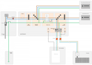

  • Having downloaded and read the installation instructions for a powerwall unit, I note they are very US centric, and the 220V model almost expects to be wired split phase, except at the last moment,  a note says to ground one side. That will be an NE link - essential when running on inverter, and expressly prohibited in UK law when running off the mains.
    Now the US do not have TNS or TT, at least not in the form we recognise, so I suspect the nuances of a UK system may not have been apparent to the original designers.
    The result, if the instructions are to be followed to the letter is  not esqr compliant. Now it may be that there is some extra bit of instruction  that UK installers know that is not in the online info, but I can well imagine a sales and help line just parroting the US style advice without too much thought.
    The wiring diagram below reproduced from this UK website  makes more sense, and has a clear NE link
