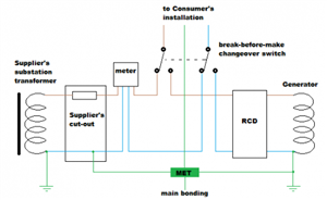

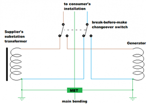

    If it helps at all, here are some diagrams (originally done for the old Forum) for the usual layout for switched alternative local generation (the principle is the same whether it's a petrol generator, or battery and inverter, or anything else).
    The first one shows the simplest case of everything TN-S - and how the generator is configured/earthed in just the same way as the DNO supply in a nice symmetric layout. When connected to the DNO's supply (and the generator off), the DNO's electrode provides the means of earthing and the local generator's earth electrode is nothing more than one more extraneous-conductive-part. When the DNO supply is off and the generator running, the local rod provides the means of earthing and the DNO's earthing system is just another extraneous-conductive-part as far as the installation is concerned.
    Then what you're more likely to have in practice, with a PME supply and an RCD very soon after the generator (as most small generators/inverters won't be able to produce the large currents needed to open overcurrent devices for ADS) - so some of the symmetry is lost, but the underlying principle is the same:
    Andy,
    Whilst these arrangements are absolutely OK for a switched alternative to the normal supply, and illustrate very well the situation about leaving the distributor's means of earthing connected, I feel it's only fair to readers to point out that they won't support either self-use or export of stored energy in connected mode. Therefore, switching for island mode in a prosumers' electrical installation is a little more tricky, involving switching of an N-E bond. This is because you can't have two N-E bonds at the same time ... and BS 7671 doesn't permit you to rely on the supplier's N-E bond even in PME.

    Definitely agreed - Mike's diagram above is far more comprehensive in this case. I just thought that sometimes it's easier to get a handle on things if you can see a relatively simple example in isolation first - it should then be clearer how Mike's more complicated diagram achieves the same thing in 'off grid' mode.
  • It's only 'my' diagram,  in the sense I have lifted it, but I think it is meant to show the NE link switching on as the mains connection is switching off. That would be ESQR compliant, though from a safety point of view it raises questions about avoiding failure modes that leave the system either un-earthed, or, less dangerously but illegally, with a DNO supply and 2 NE links
