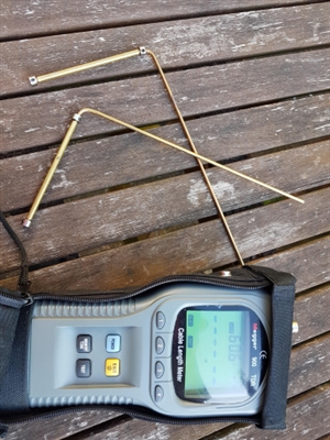

  • As a follow up to this, it has gone to the Boss to make the decision on what to do now, I've said there may be Companies available to search the route, and possibly trace the fault area. With many Companies shut down at the moment, he isnt making it a priority.
    Further testing was carried out, the armour has shorted to the blue and red cores, with a resistance of around 1300 ohms when it was tested last, the red and blue cores have negligible resistance, <1 ohm to each other, but annoyingly, it wavers, and isnt very different whichever end it is tested from. Even if we did test and find a rough length of the fault, we don't know the route, so it would be fruitless in digging random holes. The yellow core is not damaged.
    Thanks for all the pointers for help.
  • Reminds me years ago my dad was making holes for a new fence at the school were he worked and one of the boys from the school came to ask my dad why none of the lights in the school were working  turns out he'd gone through a 3 phase cable that supplied a group of the port classrooms that were more or less permenant the thing was my dad didn't here a bang or even feel a tingle despite making the holes with an iron bar
  • Sparkingchip:
    Interesting. I regularly use the second method and can explain the physics behind it. I have been known to use the first as a “last resort” but cannot explain why it also works.
    Regards,
    Alan.
