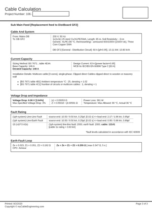

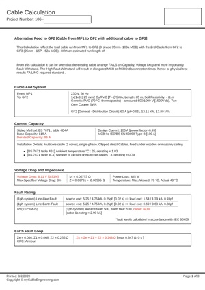

    I've made the 2015 and 2020 reports available for viewing again - I think you will find them back under their original posts.
    Also, please see below latest attempt to justify their quote to install a new cable feed to DB GF2, after I pointed out that we had proven that DB GF2 was fed by a 3-phase 100A MCCB and not a 1-phase 32A MCCB;
    I will be interested to see if you come to the same conclusion on their cable calcs as I did;
    "Yes, sorry you are correct on the routing of the feed to GF3. Unfortunately there was some confusion at our end regarding “feed to Boiler Room” and assuming this was the feed to GF2.
    However although this means that there is not a MCB Discrimination issue, there is still the problem that way GF3 is fed, results in excessive voltage drops on full load and the Disconnection tomes of the RCBO FAILS test.
    Attached is our cable sizing report based on feeding GF3 the way it is currently fed. As you can see it FAILS on all three calculated headings.
    Based on this our recommendation to run a new feed direct from MF1 to GF3 stands as this is the only way the required disconnection times and impedances can be achieved. It will also overcome the potential full load Voltage Drop issue.
    Please digest the attached report."
    (pages 2 details a different circuit not part of this issue).
    Page 3 (below) details their proposed new circuit to GF2;
