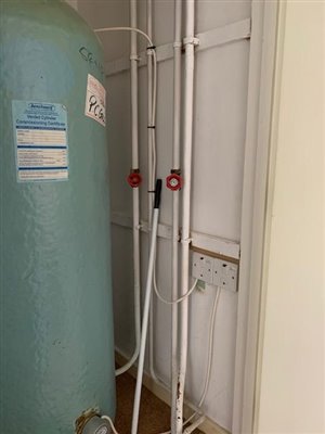

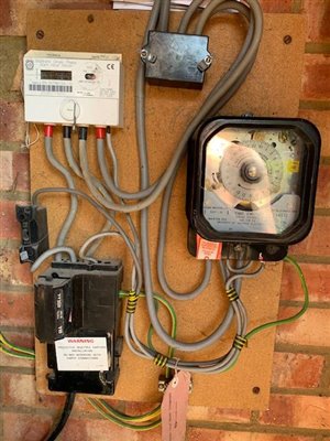

    Please see attached. I now know, they are separately connected to the top and bottom of the tank, which I haven't checked before (apologies). I thought I could read it off the tank what sort of a heater this is but can't figure it out..(the agency nor landlady are not any good which is annoying and weird at the same time). As you can see, the onpeak is wired into the bottom, off peak is wired into the top. As I've mentioned before, the off peak, even tho it gets lit as per timers settings, does nothing if the onpeak is not switched on. (I have tested it tonight) I hope this gives you more insight - i'm definitely learning from your answers.
    I should have mentioned that I have switched electricity supplier recently. (this was finished less than a week ago)
    Also, I'm not entirely sure how to set the controller against the timer in the utility room as well, it just rolls . The offpeak hours seem to be running until about 7:15 in the morning what strikes me as a very odd time.
