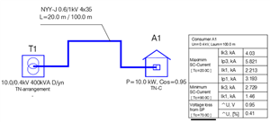

    The main problem to compare results of testing Zs and calculating Zs (and their respective SC-currents) is temperature of conductors. The temperature of conductors directly affects the test results (real temperatures at the moment of the test) or the calculation results (theoretically given temperature or temperature defined by standards).
    SC-current calculation.
    Calculation is needed to obtain the theoretical values of the largest and smallest SC-currents. According to IEC60909 the calculations of the maximum SC-current and the minimum SC-current shall be performed for each checked point.
    For example the MeteorSPEC software gives the following results for 3-phase Cu 50mm2 cable L=100m and for transformer 400kVA D/Y:
    Maximum 1-phase SC-current (temperature of conductors 90C) = 2.213 kA
    Minimum 1-phase SC-current (temperature of conductors 20C) = 1.46 kA (a fragment of the calculation report is shown at the end).
    SC-current test.
    In common case you don’t know the temperature of conductors at the moment of the test. Usually the tested circuit consists from many cable sections that are installed differently and were loaded differently before performing the test.
    You get some result, but you can’t say anything - can the SC-current be in this place at another time more or less than what you measured now.
    Test versus calculation
    Testing and calculation results cannot be directly compared. Calculation gives the theoretical possible boundary. Test results can confirm or not confirm the calculation results, nothing more.
    Thus, for the correct selection of the protective device, it is necessary to calculate the SC currents at the end points (usually enough minimum current) of a feeder and obtain the results of tests (which should be greater than the calculated minimum currents).

  • The temperature of conductors directly affects the test results
    Agreed.
    That's odd - I would have expected that conductors at 90°C to have a higher resistance than those at 20°C and hence to have a lower fault current.
    More to the point, testing confirms that the installation does achieve what the design requires - no calculation would be able to spot a damaged conductor or a polarity reversal.

    Hello Andy,
    Yes, of course, it was a mistake copying and pasting text. Thank you for your comment. The calculation report has the correct temperatures:
