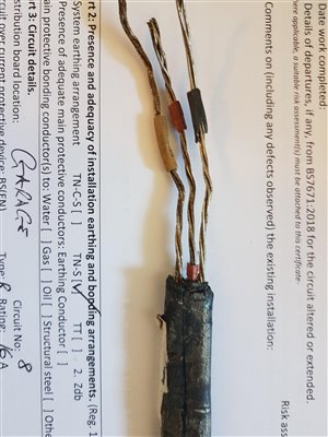

  • I went south of the river last Thursday to do what should have been a straightforward job, until I saw the cable that supplied the central heating system that I was planning to extend.
    You do have to appreciate just how bad the insulation is on some cables that are in use without tripping a RCD or MCB in a relatively new dual RCD consumer unit.
  • I actually disconnected the existing circuit completely and tapped into another one which meant taking the landing carpet and floor up, then relaying them, which was not part of the plan.
    That photo was taken whilst I was deciding what to write on the certificate as comments on the existing installation!
     Andy B.
  • No rubber cable is visible within the consumer unit at that house, so from looking in the CU you could assume the whole installation is wired in PVC insulated cable. So a bit of cable like the one in the photo is one of the things you are looking for when doing an EICR, I did not mess about doing an insulation test on that cable, but I know from experience that they can pass an insulation test even in that state.
    Inspection trumps testing.
