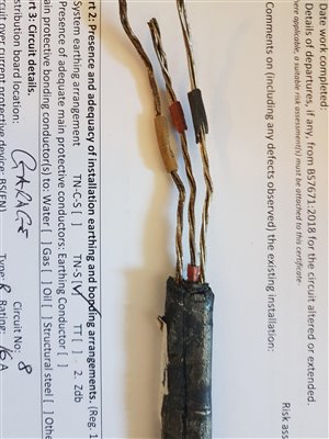

    I went south of the river last Thursday to do what should have been a straightforward job, until I saw the cable that supplied the central heating system that I was planning to extend.
    You do have to appreciate just how bad the insulation is on some cables that are in use without tripping a RCD or MCB in a relatively new dual RCD consumer unit.
    Going off topic, try identifying the conductors by the colour of the remnants of the insulation around them and although I said it’s rubber cable, I not actually certain that is a precise description. The house was built as a very upmarket semi-detached in one of the best locations in Greater London and this cable may be the last bit of the original installation from 1935 that was still in use, so may be eightty give years old, the rest having been rewired around sixty years ago.
  • That should say eighty five years old.
    This forum is very, very difficult to use on an IPad and virtually impossible to use on a phone, it really isn’t a good advertisement for the IET as leaders in a technological world.
    Andy Betteridge
  • If it is really that old it could be a vestige of a DC installation depending where exactly you were. An L-N E arrangement would not have been that common, hence all 3 cores insulated and the identical X-section. Conversion of said DC systems to what we now call TNS led to the fused neutral problem, that we have been fighting ever since.  Much earlier and it would have been more likely to be rubber covered singles served in cotton or double cotton (again, thinking of stuff I have pulled out ).
    Or it could just have been a handy bit of cable re-purposed at a time when it did not look quite so shabby.
    Pity really that rubber perishes, the tin plated copper looks to be in near perfect nick.
  • It does appear to have the red insulated conductor in the centre, which hasn’t been done for many years.
    Andy B.
  • Four areas of London still offered D.C. supplies in the late 1960’s and the last major users were theatres for arc lights and the newspapers for there printing works, with not surprisingly the last to change to the new fangled AC being the Daily Mail in 1987, entrenched in their ways as ever!
    So there are possibly still thousands of homes in London where an electrician will be trying to get a good insulation resistance value for an EICR on similar cables.
