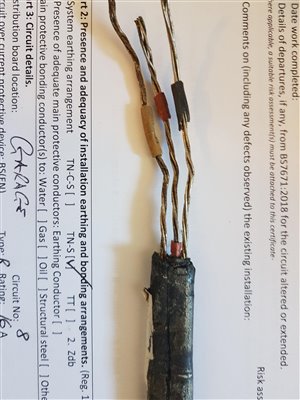

    I went south of the river last Thursday to do what should have been a straightforward job, until I saw the cable that supplied the central heating system that I was planning to extend.
    You do have to appreciate just how bad the insulation is on some cables that are in use without tripping a RCD or MCB in a relatively new dual RCD consumer unit.
    Going off topic, try identifying the conductors by the colour of the remnants of the insulation around them and although I said it’s rubber cable, I not actually certain that is a precise description. The house was built as a very upmarket semi-detached in one of the best locations in Greater London and this cable may be the last bit of the original installation from 1935 that was still in use, so may be eightty give years old, the rest having been rewired around sixty years ago.

  • Bare conductors placed out of mind does seem to be a known installation method, but not a recommended one! (some time last century we were pulling that sort of thing out, often with black cloth tape repairs as well,  clearly some is still left operational)
    The sad thing is that a cable even in that state,  laid out like that,  probably can still passes an IR test at 1000V as well as 500V, so the instruments are useful but not all-seeing -  so looking behind a few fittings at the cable itself is really important - and that cannot find the unhelpful cases where both ends have been changed, but not the hard to reach section of cable in the middle. Still, better out than in.
    edit crossed in post, but agree totally. The IR test only gets you so far.
  • No rubber cable is visible within the consumer unit at that house, so from looking in the CU you could assume the whole installation is wired in PVC insulated cable. So a bit of cable like the one in the photo is one of the things you are looking for when doing an EICR, I did not mess about doing an insulation test on that cable, but I know from experience that they can pass an insulation test even in that state.
    Inspection trumps testing.

  • I actually disconnected the existing circuit completely and tapped into another one which meant taking the landing carpet and floor up, then relaying them, which was not part of the plan.
    That photo was taken whilst I was deciding what to write on the certificate as comments on the existing installation!
