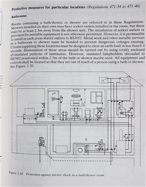

  • A reminder of the supplementary bonding requirements before RCD protection.
  • Sparkingchip, that was the 15th or perhaps the 14th edition which went mad on bonding. Really it had nothing to do with RCDs or not, and was reversed in the 16th because many of the suggestions were more dangerous rather than less. Putting consumers in a conductive location is definitely a bad idea as any shock will be much more serious. This particularly applies to commercial kitchens, where excessive local bonding and earthing makes them a death trap. Large areas of Earthed metal and a damaged cable are not recommended. RCDs do give some additional safety, as does limiting the earthed metal available to touch. Plastic piping is definitely an electrical safety measure, perhaps BS7671 should specify it?
  • I presume the room into the top left has an electric fire bonded to the central heating,  which is completely over the top. But if we are going into a home wired in the 1980's isn't that what we should be expecting to find if nothing has not been updated?
    The problem is that the bathroom had probably been updated with the supplementary bonding being ripped out,  but the fuse  board has not been upgraded and RCD protection added.
    It's digressing from the original post,  but when people say that lacking RCD protection to bathroom circuits is a C3 the bonding has to be in place to avoid a C2, so adding a RCD becomes the easiest way to upgrade.
    Andy B
  • That drawing could almost be my house, but there seem to be no gas pipes; and why is that baguette above the wash hand basin not bonded?
