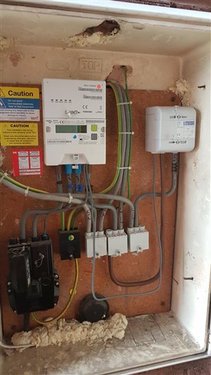

  • That’s a picture of a Smart meter with an E7 supply connected that I have posted in other discussions on this forum.
  • Former Community Member
    0 Former Community Member
    Sparkingchip:
    Am I correct in thinking (not being an electrician) the cables LL and LN feed a Normal rate Consumer Unit and the cables 5L and 5N feed an off-peak Consumer Unit that has storage heaters?
  • Yes, the peak tails go up and the off peak go off to the left.
    The whole supply go onto E7 at night, so you need to use the time delay settings on the washing machine and dishwasher if they have them to wash clothes and do the dishes overnight to make the most use of the tariff. The relay is switching the supply to the heaters.
