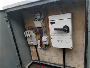

    Attached photo of the cabinet as it currently stands, (proposed MCB/RCD not installed), proposal was to replace the fused isolator with a MCB and RCD in a plastic consumer unit and have the cable to the barn (SWA/CPC) terminated only at the barn /DB1 end.  The thought to this was that the barn/DB1 earth rod would not have a low enough impedance to earth to disconnect the fuses in the enclosed fused isolator in the cabinet (on a earth fault) and so potentially allowing the SWA of the cable, DB1(barn distribution board) and metal enclosed isolator to remain live on a earth fault.
    Also looking at the cabinet you can clearly see steel threaded bar emanating from the concrete plinth and I was not sure if to connect the cabinet to the TT or PME earth or not at all.  Thinking a broken neutral pre cutout would make the cabinet live if its connected to the PME earth, hence better not to connect or connect to the TT earth?

  • And I would not rush to connect the cabinet to the DNO earth bar, but would connect it to the Crabtree Fusestar earth bar.
    I am not seeing any reason to replace the Crabtree Fusestar, insert the RCD in the tails and connect the cabinet to the fused switch earth bar seems to be all that is required. Removing the DNO main earth conductor from the intake seems like a good idea, it's of no use and is a hazard to be avoided by anyone working in the cabinet.
  • Ah - a picture speaks 1k words . Not my mental picture at all.
    Leave the outer enclosure street box as it is - the DNO kit is in effect double insulated or reinforced insulation, and no further action needed on that score.
    I'm with Andy B above. Ignore the company earth terminal altogether but get an RCD in there - it can be a high current one assuming the TT earth is good enough.
    A 300mA ordinary one will detect cable faults between it and the destination, and will not be pushed off balance by anything much less than 100mA of DC - this sadly is not a parameter written  in the specs, but given the way magnetic cores operate, is undoubtedly true. Closer protection can be afforded at the load end. Something like the second label might be a good remineder (these are Irish but a UK variant must exist.)
  • So if I'm interpreting that photo correctly, the DNO earthing facility is completely unused, and the amour of the 100m SWA cable is earthed at the load end to an earth rod?
    If it was me I would change it so that that the armour is connected to the DNO earth at the feed end and isolated at the load end.

    That creates more issues than it resolves.
    Insert a 300 mA RCD in a plastic enclosure in the tails downstream of the DNO isolation switch and lose the DNO earth terminal, if you cannot easily access the conductor at the intake end take the bar off and put some heat shrink over the end of the conductor.
    The earth terminal is the only part of the DNO installation that is exposed and likely to be a risk, it's better off out of there.

    DNO earthing is unused.
    Armour of SWA cable is currently connected at both ends i believe, but earthed via the earth rod at the load end.
