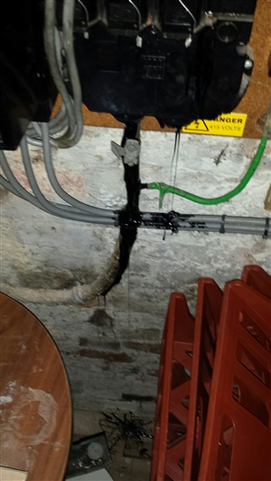

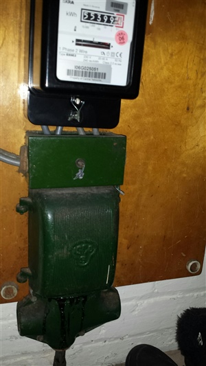

  • 1e2e91a795b86b06f25a5011588a941a-original-20078e34-17d0-42b4-b7fd-2f8a4b42f1ad.jpg

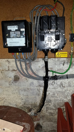

  • b566f63557b76a55f2f43e7aacc2c4c4-original-9388be01-09d1-4c6b-863e-5b12c1512f26.jpg
  • The red and black are the supply to the Chinese take away next door.
    There is nothing of any concern in those photos and I have it recorded as emails, which is where I retrieved the photos from.
    Had I been preparing an EICR how should I coded it, at all?
  • Any EICR observations in this photo?

  • The tar going  a bit soft may only indicate it has reached a temperature that is still within the safe range for the cables and terminals.
    However the 'glooped' green on the earth tail (unless that is just badly stripped end or loose tape looking like melting) would seem to tell another story, one of being far too hot to touch, and therefore a hazard.
    I must say in your shoes, assuming my feet fitted, I'd be more than a little disappointed at that DNO response.  Perhaps the folk adding bits to BS7671 saying we should be looking at the DNO kit need to be asked to include a few pictures of perfectly satisfactory installations like this, to calibrate our and their expectations, and to stop them worrying about consumer unit fires and AFDDs.
  • Have a closer look at the Chinese takeaway connection in the first photo, which involves quite a bit of insulation tape. If you or I made a connection like that it would be a C2.
    There is no chance of the loads being balanced across the phases, so presumably any or all of the live phases could be running hot as could the neutral.

    The second green intake has some melted bitumen as well as looking like it might have double pole fuses in it.
