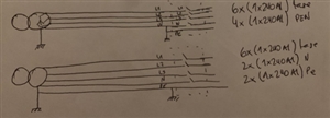

Im having some doubts regarding where I should ground the Neutral and why ?
This is a new installation which is in an industry that will have its own substation 15/0.4Kv with a transformer of 1250KVA 15/0.4KV DY.
This substation will only feed the MainCircuitBreaker of the plant which is located 80meters away from the substation, there will be no other consumers from this substation/transformer.
The cables are already buried. They will be 6 cables per phase alluminum 240mm2 and 4 other cables 240mm2 alluminum also that could be used for neutral or PE or PEN depending...
Should I ground the neutral the the transformer ? at the income of the LV MCB ? at both sides ? run only a PEN from substation or run Neutral and PE separate ?
These are the possible options i was considering.. and was hoping some of you guys give your opinions.
Remember the distance between the TX and LV main panel is 80m
In the picture the PEN in option 1 and earth in option 2 is grounded at both sides (transofmer and LV mainboard)
The other options would be as 1) and 2) but grounding only at one of those sides... (those would be pure TNS or TNCS)
Whats your opinions ?!
Thanks in advance!!
  • The answer is that both are done, but in different circumstances. Also I'm far from expert on this, so wait for other to chip in. There are some questions that will help clarify the situation.
    1) Is this in the UK? - if not the answer may change - here there are special rules about multiply earthed neutrals and other countries may do different things with HV side earths and fault detection.
    2) How is the HV earthing to be sorted ?
    If the site is "cold" (DNO may be needed to advise on characteristics of the HV side to determine this) then the HV earth -i.e. the transformer core and tank, and the LV earth i.e. the star point of the transformer and your PEN, may share earthing arrangements, and indeed if it is possible, then  it  is preferable if they do.
    If the site is "hot" - that is to say a credible HV fault current could provide enough current to raise the HV earth to a dangerous voltage, then the HV and LV earths must be separated systems, and must not be co-located,
    If the LV earth needs to be remote from the HV one where is it best physically?
    How far apart are the TX and the building with the breakers an so on?
    Mike.
    Mike.

    1) This is not in UK but I have found this forum very helpfull and people with lot of knowleadge that might help me !
    2) In the substation there is the earthing grid below the substation. I dont know what you mean by hot or cold..
    The substation is 80 meters away from the main circuit breaker and might me like 180 meter from the las circuit breaker.
    The contractor suggested me to ground the neutral only at the main circuit breaker, and not at both sides..
    Also to tie the earth grid of the substation to the LV earth where the neutral is going to be grounded.. (80 meters away one from the other)
    They will be tied with a 240mm2 Al cable.
    Whats your opinion about this ?
  • I dont know what you mean by hot or cold..
    It's an old UK rule of thumb for deciding whether the HV earth and LV earth are combined or kept separate. Generally if there's a metallic path back to the HV source for earth (or some other means of keeping the HV earth below 1Ω) (cold site) then the earths are normally combined. Otherwise (hot site) the HV and LV earths were kept strictly separate so HV faults weren't imposed on the LV system.
    I gather that these day the process is a little more sophisticated and a proper calculation for the rise (and duration) of earth potential in the case of an HV fault is done.
  • The contractor suggested me to ground the neutral only at the main circuit breaker, and not at both sides
    I think it's usual to earth the N at just one point - as that tends to produce better EMI results as there's less current flowing unbalances around random metalwork or soil. In the UK it also avoid legal complications of a "consumer" having a combined neutral and earth conductor in their installation.
    Whether N is earthed at the transformer or switchboard end tends to vary depending on the circumstances. With one one consumer DNOs tend to favour earthing the N at the consumer's end (PNB) as that reduces the potential difference between N and PE for the consumer. Clearly where the HV and LV earths have to be kept separate it's likely to be convenient to earth the LV N away from the transformer, if they're combined it might well be easier to earth everything together at the transformer.
