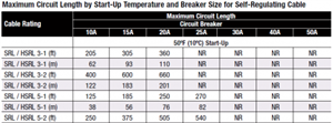

3. How the Maximum circuit length is determined according to the breaker type? What is the equation used here? (see the picture below)

    3. Who knows?  Ask the manufacturer.  Roughly speaking, the current is proportional to the cable length.  But the breaker values there only vaguely approximate to that.

    However in either case there are now a couple of considerations when sizing the breakers.
    1 temperature matters - no good if the current is so high the breaker fires on a cold morning. (!!!)
    2 the wire has resistance - but if the cable is cut and shorted out near the far end, you need enough extra current to flow, (even on a hot high resistance sort of day), that the breaker will trip correctly.
    The practical upshot is that there is both a max length and  breaker rating limit for the breaker to work if there is a  fault, and another breaking limit for a given length for it not to fire on cold days. the table tries to indicate a range of sensible cable lengths for a given breaker rating.
    In general short runs of trace cable are easy, and long ones are better sub-divided or fed from the centre outwards.

    The MINIMUM size of circuit breaker is determined by the need to avoid tripping when first turned on in cold conditions. The actual operating current may exceed the MCB rating, but only briefly and should remain under the thermal trip curve.
    The MAXIMUM circuit breaker size is determined by two factors. Firstly, if the heating tape suffers internal short circuit or external damage then an over-large circuit breaker makes "a bigger bang" with more risk of fire or other damage.
    Also the PTC heating tape consists of two copper wires that run the length of the tape, with the PTC material between them. Like any other conductor, these copper wires have a finite current carrying capacity and that limits the size of OCPD that can be used. They are however pushed much harder than copper house wiring cables.
