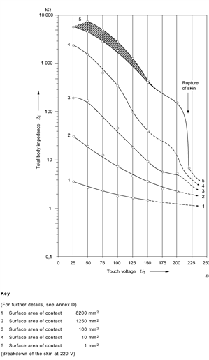

I am a bit confused by this. Why do the disconnection times in Table 41.1 appear to be based on a touch voltage of 100 volts rather than a touch voltage of 125 volts?
For example, 110% of 230=  253 volts. Assuming L and PE are of the same size and material, indirect contact touch voltage is 126.5 volts. Would 0.33 seconds not appear more realistic?
From IEC 61200-413

    The fact I say 'current' and not 'voltage' is significant.  Skin resistance of 5k-50k ohms per square cm of skin means that only a large area contact will get anywhere near the 30mA of the RCD threshold, in turn based on the lethality date. Shock current in terms of contact resistance is the single biggest variable in all this.
    Skin conductance per area should be treated with caution when getting to small (few mm2) areas and large proportions of 230 V across the skin. When applied voltages are over some threshold, typically below 230 V (e.g. 200 V) skin can quickly become more conducting. This is included in some plots in IEC 60479-1. For example Fig.5 (2018) shows the 1 mm2 contact resistance collapsing to around 7 kΩ around 220 V (50 Hz) compared to over 200 kΩ at 200 V. The quick transition is labelled 'rupture of skin'. Ok, that figure is only based on 'one living person': a lot else about impedance with substantial voltages is on larger numbers of corpses. But I can verify tripping a 30 mA RCD from contact of a 1.5 mm2 conductor-end (from a cut-off wire, insulated except the 1.5 mm2 tip) on a palm, with 230 V,  when the other body connection was a good one; it left a white spot. As long as there are fairly poor contacts at both the 'entry' and 'exit' then the split of 230 V between them prevents this level of skin voltage being achieved.
    (Following a recent discussion of units, how should that skin 'resistance' be described?  It may be 5 to 50 kilohms for a 1 cm square [for a given voltage and condition], but saying e.g. "50 kΩ per cm2" suggests 500 kΩ for 10 cm2.  Instead, writing as 50 kΩ·cm2 would be the strange-sounding way that shouldn't be able to be misunderstood. Alternatively 20 µS/cm2. Yes, I know no one who thinks about the subject would misunderstand anyway...)
  • A very similar curve is in the older editions too. However the pinhole breakdown mechanism is thermal, and takes a some tens of milliseconds to occur - by then an instant RCD should be thinking about de-latching, if it has not already done so, I'd be nervous about relying on anything with a much longer disconnection time. Note that this hot spotting seems to be a feature of smaller contact areas only.
    I agree the figures need to be taken with a pinch of salt, or perhaps not, if your hands are wet ?.
    Also it is not clear which body parts this relates to,  and skin thickness varies quite a bit, palms of hands can be over 1mm to 1.5mm thick, while more delicate bits are less than half  mm  (ref)
    Mike.
    Curve 3 is the square cm or so of contact, on this subject between 2 and 3 k ohms at 250V, and more like 10-20k at the sort of  touch voltage you see in a TN system.

    mapj1:
    The disconnection time needs to be a fraction of a heartbeat period to significantly reduce the risk of fibrillation.
    Animals with faster heartbeats, like mice and lab rats can be killed by shorter current impulses than humans..
    The fast disconnection will work with fuse or MCB, if the fault path is mostly metallic and the human is in parallel with some of that 'wire wound' resistance all will be well, RCD or not. The time an RCD is most useful is when the the human is in series with the fault path, or something else limits the current,  like  a liquid path rather than a metal one, as in that case the fault current will be utterly incapable of operating even the smallest fuse or breaker.
    M.
    Well, perhaps. AC-3 in Figure 1 of IEC-61200 does not indicate ventricular fibrillation, 5% at curve c2.
    I fully agree with that rest though.
