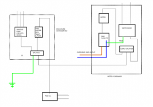

I am trying to get my head around surge protection - the *basic type and positioning* really- and taking an example situation please where surge protection may be added:
A moorland, overhead supplied, residential property; TN-C-S.
Outdoor regular wall meter cupboard in which is the DNO head, meter and some existing consumer switchgear (been as it is for over a decade with RCDs, MCBs from when the supply was TT) in an enclosure fed via a supply splitter block [henly] , which is there to supply two consumer units each at either end of the property.
Also fed from the splitter block, a supply to another nearby enclosure in which resides switch gear for TT outdoor services - lamp columns and electric gate 30ma RCBO final circuits and a  RCD type s distrib circuit to a 'garden work pod' which has a little sub-board.
(rough block diag attached to help description)
1) What would be the positioning and type of any surge protection  (where there is no LPS on the building rightly or wrongly)   ?

  • As far as I recall BS 7671 only demands type 1 SPDs where the building has lightning protection - but there does seem to be generally accepted industry advise that type 1 should also be used for overhead supplies. So I think it's a case of you pays your money and takes your choice on that one.
    I think you'll need SPDs in the TT part too. SPDs operate by shorting conductors together (e.g. L and PE) - so tend to raise the voltage on PE just as much as they reduce it on the L - indeed on a TN-C-S supply you might well find that the surge is pretty similar on both the L and PEN conductors in the first place so the SPD might have little to do. However take the live conductors into a TT area and you're almost back to square 1 again as the TT earth won't have have had the benefit of being 'pulled up' by the SPD in the TN installation. For instance, say we had a 10kV surge on the supply L - the TN SPD shorts L to PE so bringing L down to not much above 5kV and pulls the TN PE up to almost 5kV - the TN installation only sees the difference and so is happy, but the TT installation, with it's PE still at 0V sees 5kV between L and PE. (Or even worse case a 10kV surge is imposed on both the supply L and PE - TN SPDs have nothing to do, but the TT installation then sees the full 10kV).
    Generally there shouldn't be type 1 or 2 SPDs downstream of 30mA RCDs - both because the RCD is likely to nuisance trip if a surge occurs (if you're lucky) and (if you're unlucky) the RCD itself is damaged by the surge as it lacks upstream SPD protection. S-type (time delayed) RCDs can be upstream of type 2 SPDs - but often it's better to have CT2 wired SPDs before any RCDs - although a lot of care is needed to ensure that there's no possibility of a L-PE fault before the first tier of RCDs in a TT system.
  • A couple of other points. A type 1 SPD won't necessarily protect electrical equipment - it's designed to temporarily equipotentially bond the supply to the LPS so there's no flashover and fire. So it's beefier but slower. So you'd need a type 2 in conjunction with it, and indeed some SPDs are sold as combo type 1 and 2's.
    Second, its generally recommended that a further SPD is added to DBs which are 10m or more downstream from the main SPD. This is due to a ringing effect which can double the transient voltage further down the wire. E.g. a 4kV spike on the supply is reduced to 1.5kV by the SPD at the main DB, but is 3kV by the time it reaches the second DB.
