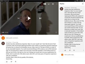

  • 41b84d0dd20391f681be07847397dd73-original-07adc68c-3b26-407c-993f-39d1691d8ab4.png
    @davezawadi (David Stone)  as you said to Jordan of Artisan, perhaps you would care to list your qualifications for EICRs and in addition detail how they match the criteria set out in the legislation as I posted above.
