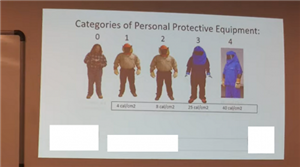

How to determine Arc Flash level?
This image is from some training in the US, so do the cal/cm2 figures translate to use in the UK, and how do we calculate/determine the Arc Flash level?
Thanks
F
Arc Flash - categories of PPE
  • Tis complex. Very complex.
    But there are very simple ways to put an upper limit on how bad it could get when it is all stacked against you..
    First you can metricate calories to joules with a factor of 4.2 joules per calorie to get a rating for the overalls in real units, as opposed to Diet numbers.
    Around 5 joules per cm2 is the onset of something more permanent  than a bad sun-tan for bare skin, though to set a safe limit that is quite a bit less is better and leaves you with more hair on your arms.  (some US literature quotes 1.2cal/cm2 which is about the same, as the onset of permanent scarring.)
    edit to set an expectation, in the test facility where I work (not a mains arc test facility, but we can certainly make some noise..)  a figure of 1 joule is used as the ‘action limit’  i.e. below that no special precautions need be taken, above that we start to think properly about it.
    You can estimate the energy of the arc (volts times pssc amps times disconnection time) to get total joules of energy that could ever be in the arc between the time of onset and ADS doing it's thing. Note that actually you can safely quarter that, as when drawing the PSSC, the voltage at the fault has fallen to zero, in reality the power for making an arc - the I*V product -is maximum near to half voltage and half PSSC flowing.
    Then you need a geometric factor - in free space the energy of the arc will spread out in all directions, and you can imagine those joules smeared out over the inside area of a spherical shell (like flattening an onion skin and measuring the area) This gets you so many joules per square cm or square m  at any given range like hand length or arm length..
    Arcs in confined spaces are worse, as the energy that was going towards  the back and sides of the box may be redirected forwards, and  while the energy total is the same, we have robbed Peter to pay Paul and it is now safe to get closer  behind the box (duh well yes) but more dangerous to a greater distance in front of it.
    A factor of 2 or 3 in the worst case direction, relative to spherical,  is typical.
    By you have worked out a few you will find that a typical lighting circuit (PSSC of a few hundred amps disconnection less than 100msec ) needs no skin protection at all, unless you are within about 6 inches, while a bare bus bar off a 100A fuse deserves arms length treatment, or the fancy overalls.
    There are far more accurate methods that allow for not all the arc energy being turned into flash, and the extra voltage loss in establishing the arc, but they all reduce the exposure compared to the outline method above which gives a very safe first boundary estimate.
    AFAIK the PPE to EU (and UK) standards is all rated in cal/sq cm so you won't be helping yourself doing that … stick to the diet ?
    In the UK, our working practices and Forms of switchgear assemblies usually sort this kind of thing out, at least for LV AC. Notable exceptions include types of work done by DNO/meter operator.
    DC batteries are another matter. If working with strings of batteries, I'd recommend a risk assessment similar to the process included in the IET Code of Practice for Electrical Energy Storage Systems, 2nd Ed (this is based on the approach in the Australia/New Zealand standard AS/NZS 5139). Hopefully, manufacturers of commercially-available packs have already done this risk assessment for you, and have some recommended practices and instructions, along with the anticipated energy levels for PPE etc.
  • I agree. All Arc Flash PPE we have bought in the UK, is sold and marked in cal/cm2. You won’t find anything marked in joules.
    Regards,
    Alan.
