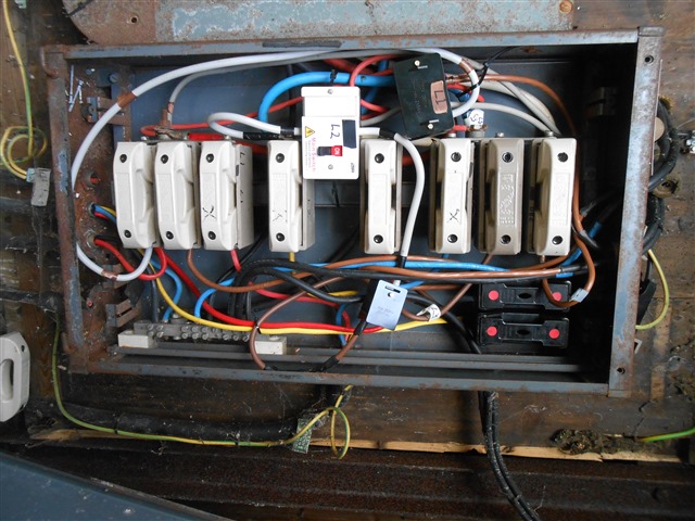

The top of the ceramic fuse carrier bases have flat bus-bars that are held by screws onto the fuse bases and internal contacts. Because some of the fuse carriers have suffered from heat/corrosion damage "repairs" have been made. Electrically it is sound and still in full working order.
Z.
No, that's not it. I appreciate that you have seen it in the flesh, but there are at least 3 fastenings, possibly 5 lying on the floor of the box - the side with the hinges. So either gravity has put them there, or somebody is playing games with a magnet.
By my reckoning, the L2 switch should be upright.

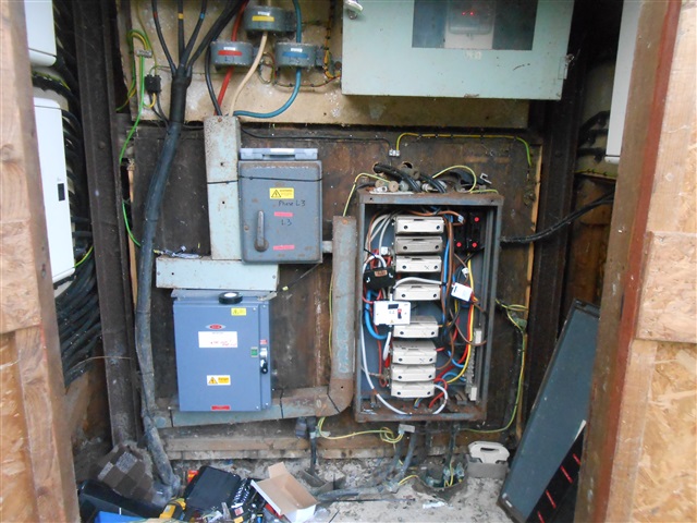

Only for you Chris, to solve the mystery I have searched for another photo to put everything into context. You are looking at an antique operational installation. Yes, I know what you are thinking.
But, what is the earthing arrangement?
Presenting as TN-S - is this site large enough for a private or at least dedicated transformer so there will not be unexpected changes to Zs and PSSC? The singles running the current transformers look a bit unrestrained and near the edges of that duct with the lid held on by cable tie, so I hope the earth wiring for that is going to win a race with the supply fuse.
Compared the phase conductors all the green/yelllow and some of the black looks a bit thin.
Given all the outbounds seem to be single phases 3 boards might have been expected, or are there some 3 phase sub mains going out ?
Certainly one where you would not start from here nowadays.
Mike.
The incoming is 400 Volt from overheads. There is no dedicated site transformer. The main earthing is provided by a single large conductor running downwards that disappears into a duct with the supply cable. P.N.B? I commented on the current transformer wires many months ago but was told on this forum that they are probably o.k. as they are housed in a locked room.
The three main D.N.O. fuses are rated at 400 Amps each.
All chalets are TT earthed.
