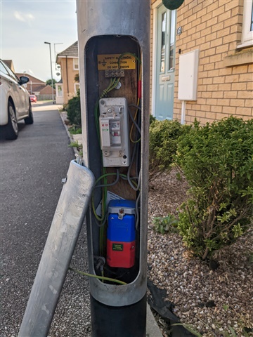

Does anyone have an insight into how Councils control street lights? My client is a residents association in a private road just off a Lincolnshire County Council public highway. They have seven street lights in the private road, each appears to have a single feed to them and there is no (apparent) control box for them - it appears their street lights are fed from the public highway (unless I am missing something). In the middle of the night the public highway lights get turned off, but those on the private road do not.  I have been asked to quote for providing a timer(s) for the lights  in the private road - in my opinion the installation cost and inconvenience in the event of power cuts does not justify this approach - am hoping they can be included in whatever switching on/off the Council do. Any pointers please on who to speak to to see if the private road lights can also be controlled by the Council?

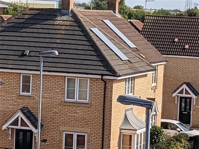

  • Have looked into this a bit further - thank you for all who have responded. I do think there is a photocell on the lamp head - photo is not entirely clear though. It seems that Lincolnshire county council might charge £300 per lamp (2019 prices) to convert them to be controlled by radio signal, and that is assuming they might also take on responsibility for the lights in future, which is not guaranteed. I am now considering if I can squeeze in a Sangamo 72101 timer in an enclosure at the base, though space is tight!

    With regards to introducing a Sangamo timer in the base of the column I can confirm that this is very common, but perhaps more labour intensive in the long run due to varying ambient temperatures affecting a potentially sensitive timer PCB. Most electronic timers have a battery back up so power cuts won't necessarily be an issue. Historically, manual operating din rail mounted time clocks were used in column isolators (such as the Hager EH010), but these have been phased out over the years and replaced with digital products.
    Many street lighting manufacturers will offer you a design and price for a small prewired isolator with 2P switch, fuse, timer and/or contactor to replace the light grey (Charles Endirect) enclosure at the top of your column base in the photo. As it is, the enclosure currently there is only equipped to house 2 standard din rail devices, therefore a new 3 or 4 module enclosure will be required for connection into the DNO cut out.
  • I do think there is a photocell on the lamp head - photo is not entirely clear though.
    It doesn't look like there is a photocell attached to these lanterns but it's difficult to confirm.
    One other solution (which might be a long shot) is that the lanterns are fitted with a pre-programmed ballast with factory set on/off times. This would explain the lack of control device in the column base or on the lantern. I used to program quite a few ballasts like this around 8 years ago so there are certainly a few out in the wild!
    Either way, best way to confirm is a full inspection of the lantern.
