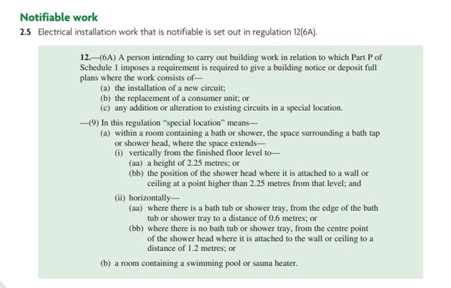

  • Are you in Wales ? If so it is notifiable.
    In England, not notifiable, as not a completely new circuit, nor a new CU nor within 60cm of a bath or shower. (the only 3 notifiable electrical works these days)
    The original version of part P had garden wiring as notifiable, and a load of other things as well, but England dropped that in the 2012 revision - you may be looking at something based on older advice.

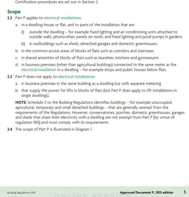

  • Hi Mike,
    Thanks for that, see below an extract from the Part P document, am I reading it correct?
  • England dropped quite a few of the bits required for notification purposes some years ago whilst Wales stayed with it. So it might depend where you are as far as that is concerned.

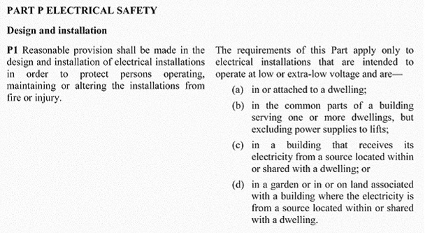

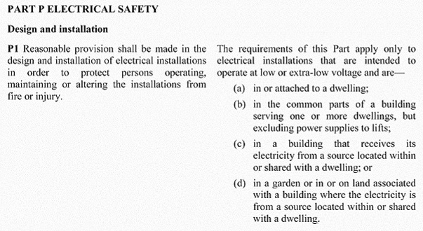

  • That is true. Part P does apply to those areas, but Part P merely states that all electrical work must be done to ensure safety.
    That is It in its entirety.
    However, you are confusing Part P (above) with Regulation 12 which states the notification requirements in England (Schedule 4 still in Wales) and Approved Document P which contains the actual legislation (in shaded green areas) plus a lot of "guidance".

  • that is quite correct. Part P does not apply, even to new circuits, new consumer units or work near a bath, in any other classes of building.
    But note that is only an  approved document, and that is  the civil service interpretation of one way to meet the law. The actual law for England  is
    here The notifiable works are only as described in para 6A of reg12. Nothing else legally  requires notification in England. Though of course you still have a duty of care and should do proper checks and not leave live wires hanging out etc.
    Mike.
  • Part P applies to ALL electrical work in dwellings and associated areas.
    That some work might be notifiable - or not; Part P still applies.
  • The Notifiable section is a bit further on, in paragraph 2.5
