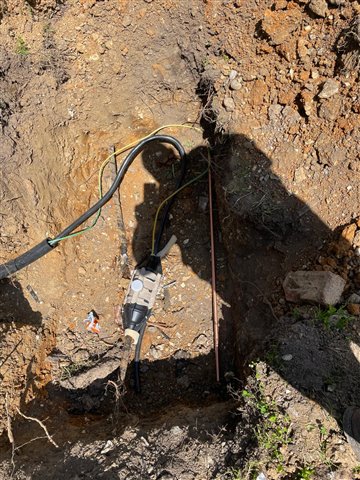

    The problem is understandable as DNOs connect more to an ageing network. Here, a “new” 69KVA supply to a restaurant project we are involved in. I don’t have the paperwork to hand but I believe the earthing was stipulated as TN-S . Photo 3 is the supply to neighbouring property.
