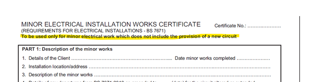

  • The question is it a requirement for the principal designer to have it signed? The standard doesn't require us to sign, only as per the respective responsibility?
  • Principal 'CONTRACTORS' have appointed sub-contractors for the installation of new DB, that then became an as fitted design, in which the principal contractors did the design. Now a new subcontractor comes a long a installs a new circuit on that DB, in which another as fitted design has to be done. And in accordance with the client standards the principal contractor only had responsibility for completion and inspection which has been complete. Therefore is a signature required by the principal contractor under the design section, if the client has or has not asked for it?
  • Yes, but not a lot you can do about it. Assuming that you were the installer, provided that you followed the design, you have nothing to worry about.
