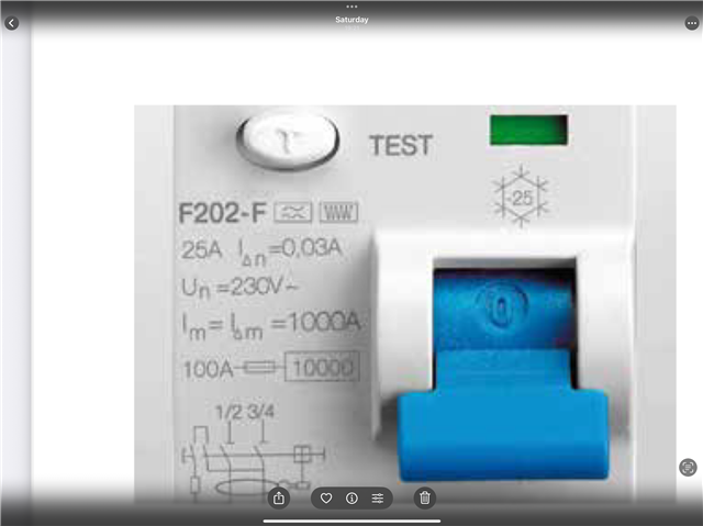

Just seeking a wee bit of clarification on I delta m. Literature indicates that it is the maximum breaking capacity of residual current as distinct from the maximum breaking current. Just not sure how to interpret that.
On an RCD the only thing it breaks on in is a current difference.
On an MCB the only thing it breaks on in is total current.
But an RCBO and perhaps some clever programmable breaker design, really has two mechanisms for operating the contacts, and maybe these operate at different speeds, so the time for contacts to be damaged (burnt) is different.
Now we may have two different Im maximum fault currents to do the same damage as the contact heating and arc damage is all about I squared R *time...
In those cases when its not obvious what we meant, we need to distinguish the 'Im' s for the 2 kinds of fault and this is one way to do it.

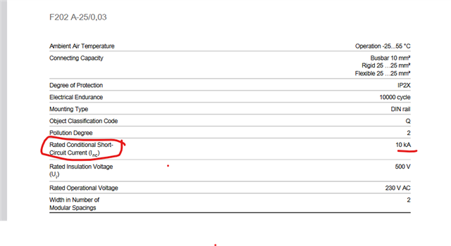

And then to totally muddy the water, if it is installed after a 100A death or glory fuse (to further limit the time/ energy ), then the it is conditionally rated to 10kA.

This is a RCD so breaks only one kind of fault. Are they suggesting 1000A if no death and glory 100A fuse but 10000A with one? I have searched a lot of literature but cannot find a definitive answer.
I think that is probably what it means.
This link may help - see page 11.
As I understand it, Im is the rated breaking capacity and IΔm is the rated residual breaking capacity.
Confusingly, in BS7671, Im is something completely different.
yes - because the fuse goes first and by cutting the arc short limits the energy available that would presumably otherwise irreversible burn up or weld the RCB internals - presumably to an energy equivalent to about 1 % of the time that the RCD part alone takes if damage goes as I squared....
Energy limiting fuses really do save the day. It is not really a cleanly switched rectangle of current of ten times the magntude for 100th of the time of course -that's just the mathematical equivalent energy.
The actual effect is much weirder; as the fuse starts to open it inserts a time dependent resistance, as the energy from the voltage dropped accross it is dissipated to create first the molten metal then vaporising it and then throwing it about, hopefully all the while staying inside that ceramic cylinder.
I really can't see why they need to put Im -= I delta m as you say is an RCD - so a plain Im would do.

Just thinking aloud... I guess the RCCB could be asked to break L-N currents that are larger than the residual current in a few circumstances - e.g. a bolted L-N-PE fault on a TT system. Hopefully in that situation the fault protection would open first, but maybe the thinking is that by specifying Im, the effects of L-N faults on the RCD have to be considered as well.
