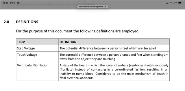

  • BS7671 does not actually mention “Touch voltage” it refers to simultaneously accessible parts.
  • I cannot see a definition of touch voltage in BS7671, but here is the National Grid definition:
    commercial.nationalgrid.co.uk/.../229258

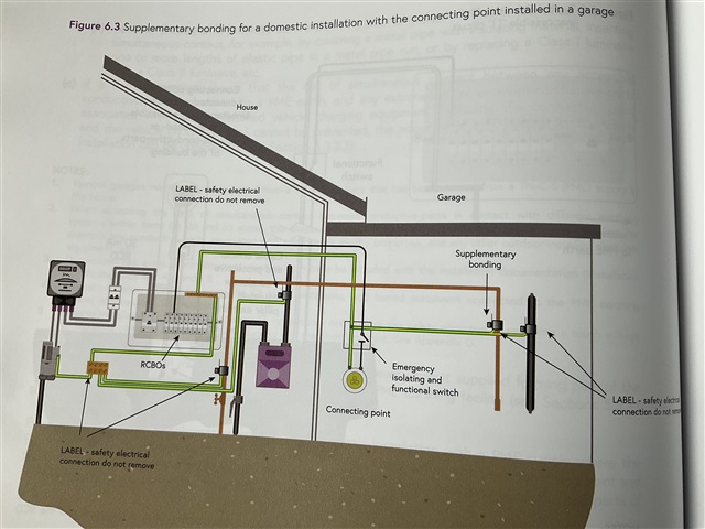

  • I have a particular scenario in mind in which there is a complete failure of the Protective Measure- Automatic Disconnection of Supply (ADS) due to circuit protective devices both MCBs and RCDs, as well as fuses and RCBOs, being completely ineffective, because of a failure of the earthing system, which results in there being a recommendation to install supplementary bonding to provide additional protection.
    Edit- I have just checked and as I thought, Graham is the lead author of the book I am looking at and I’m sure he knows where this is going.
  • because of a failure of the earthing system,
    Such an arrangement would not meet the requirements of Section 411, and, if a workplace, possibly not the Electricity at Work Regulations (Regulation 8) either?
    It would be better to use an alternative means of protection against electric shock, such as Class II equipment or SELV.
    To be clear, a broken PEN conductor is not necessarily a broken earthing system ... although it does involve EPR due to a broken neutral. However, I can see cases where it can be ineffective earthing in which case see Regulation 114.1 of BS 7671 and the ESQCR.
  • BS7671 114.1 states that for a supply given in accordance with ESQCR it shall be deemed that the connection with Earth of the neutral of the supply is permanent.
    BS7671 Section 722 and Annex A722 does seem to contradict that statement, and the EVSE COP guides us to taking an Open-PEN fault into consideration with supplementary bonding being additional protection that we may consider installing in some circumstances.
