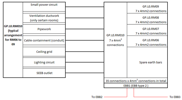

Cable size between equipotential earth bonding bar and distribution board in a Group 1 medical location
The IET regulations require that the resistance of the conductors, including the resistance of the connections, between the terminals for the protective conductor of socket-outlets and of fixed equipment or any extraneous-conductive-parts and the equipotential bonding busbar (EBB) shall not exceed 0.2 Ω.
However the cable connection between the EBB and the Main Distribution board, is not defined, (identified in red in the image below) - either in terms of:
 1 - maximum resistance
2 - minimum cable size
3 - if the cable needs to connect to the distribution board that serves the room or should go back  to the Main distribution board.
4 - if there are number of EBB's can they be connected by a single cable in a daisy chain arrangement back to the distribution board.
Is any able to provide guidance on the four questions above?
    710.415.2.3 The EBB shall be connected to the system earthing using a protective conductors having a cross-sectional area greater than or equal to the largest cross-sectional area of any conductor connected to the EBB.
    Connections shall be so arranged that they ... can be individually disconnected.
    To my mind, that is not consistent with a "daisy chain".
  • Thank  you for that.
    Question 1 and 2 - is answered by regulation 710.415.2.3
    Question 4 - is answered: they should be individual connections so that they can be individually disconnected
    Can you advise regarding Question 3?
  • Well, 710.415.2.3 is silent on the location, so I would say anywhere. Fig 710.2, which shows a typical theatre layout, simply has a bit of G/Y labelled, "CONNECTION TO PROTECTIVE EARTH IN DISTRIBUTION SYSTEM". One end is connected to the EBB and the other to a rectangle labelled, "TN DISTRIBUTION SYSTEM" from which I conclude that the local DB rather than the origin suffices.
    HTH.
  • BS 7671 doesn’t specify a minimum size for the conductor between the EBB and the distribution board, but best practice aligns with:
    1. Resistance: Keep total resistance (including terminations) as low as practicable—typically ≤0.2 Ω applies to protective conductors within the location, not the EBB-to-board link.
    2. Size: Match or exceed the largest protective conductor serving circuits in that medical location; often 6 mm² or 10 mm² copper is used.
    3. Connection point: Ideally to the distribution board feeding the Group 1 location, not necessarily the main LV board.
    4. Multiple EBBs: Daisy-chaining is permitted if each link meets continuity and fault-current capacity requirements, but a dedicated radial is preferred for reliability.
    Refer to BS 7671 Section 710 and HTM 06-01 for healthcare-specific bonding guidance.
  • The 0.2 Ω limit applies to all protective conductor connections to the EBB. Between the EBB and the main board, the cable should be sized for fault current (typically ≥6 mm² copper) and can either connect directly to the main board or via local distribution, as long as total resistance stays ≤0.2 Ω. Daisy-chaining multiple EBBs is acceptable if this criterion is met. Always verify with post-installation testing (BS 7671).
  • There is another criterion not listed in the OP.
    Effectively, Regulation 710.411.3.2.5 imposes a touch-voltage limit of 25 V AC / 60 V DC (see Regulation 710.415.2.2).
    This effectively modifies the formulae in Regulation 415.2.2 to:
    R ≤ (50 V)/Ia for AC circuits
    R ≤ (120 V)/Ia for DC circuits
  • Good point. The touch-voltage limits (25 V AC / 60 V DC) indeed set the maximum earth resistance for safe operation. Using a practical approach often recommended for protective device calculations:
