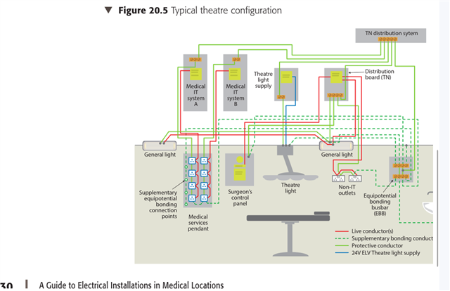

  • Are the diagrams in Fig 710.2 and 710.3 not illustrative of the requirements?
    They are, but although Fig 710.2 shows the "connection to protective earth in distribution system" (to the left of the EBB), it does not specify where the other end is attached to the system earth. It merely shows TN distribution system, which implies that a local DB would suffice.

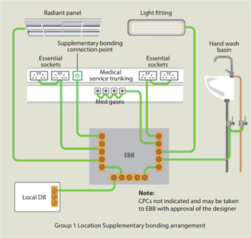

    The IET publication:  GUIDE TO ELECTRICAL INSTALLATIONS IN MEDICAL LOCATIONS
    Has the following diagram:
    This diagram does show the connection to the local DB - and hence the comments made the hospital engineer, would appear incorrect. Is there a consensus on this?

  • In BS 7671:2018+A2:2022+A3:2024 there is no diagram for Group 1 EBB connections to the TN system, just for a Group2 location, which I included in my original; question. I recognise that guidance document is from 2007, however it is the only current document that shows a Group 1 image which is why I used it.
    Amendments to the regulations with respect to this part of the installation since that date have not changed.
