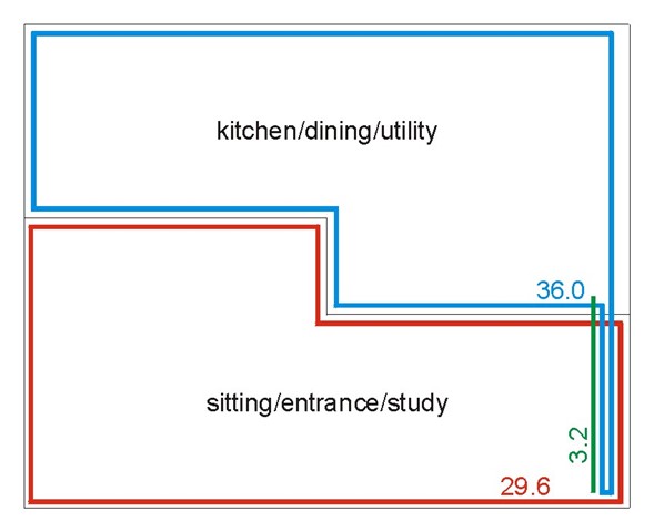

  • Between  two rambling houses I suppose you may have half a km of cable in total
    That seems a lot. 10 circuits at 50 m each?
  • That seems a lot
    It is. it was meant to be a limiting upper-bound sort of figure, and assumes large houses, long submains to sheds down the garden etc.  I reckon a small bedsit flat may be a tenth of that...
    Mike.
  • One reel per circuit feels like a reasonable upper bound to me - considering we're talking total amount of cable rather than length to furthest point. If it's two houses,10 circuits across both might even be an under estimate,
    The largest of the dwellings which are going up in a fancy development near here are around 160 m². Let's say roughly 8 m x 10 m for each of two floors. Downstairs is divided approximately diagonally. Modern open plan living limits sockets to outer walls. I reckon one socket circuit for each half plus the cooker. I have put the CU in the corner, but with rings the location is not critical. I get a total of about 70 m of cable for downstairs.
    Yes, I know that there will be an EVCP, which might be on the far side, and a heat pump round the back, but I still struggle to get more than 200 m even into what may be regarded as a spacious house nowadays.
