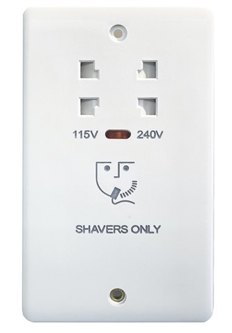

I've been asked to add a USB charging port into a bedroom with a bath in it.
My understanding of BS7671 is that a room with a bath is a bathroom. As such the outlet would be in zone 2 of the bath.
Would I need to power the charger via a safety transformer and could this be built into a +IP4 enclosure similar to a shaver outlet
Thanks for your assistance

     Chasssis mounted USB sockets  link to one example, can look quite smart on a suitable blanking panel. there are also modular grid socket versions both with PSU and where a USB cable comes out the back,
    A variation on that theme might be worth considering with the actual supply protected either in a cupboard or outside the bathroom altogether, and just the USB cable coming into Z2..

    I make special plates so I could use a simple ipx4 socket in and ipx4 plate/ back box configuration with a USB outside zone 2 or even 3. But am I allowed to embed the USB extension cable in the wall?
    I also think the USB brick (230vac to usb) has to be hard wired?
  • Well a USB cable in the wall is an example of ELV, so arguably safer than a mains cable in the wall (!), the hardest problem will be threading it through a suitable route with the plug on, and the distance cant be too long, as the voltage drop at 5V becomes proportionally more  serious. The mains to USB converter  would have to be hard wired if it was in the bathroom Z2, or indeed within 2.5m of the edge of the bath or shower tray.
    Outside that distance you can have a normal 13A socket. It must be said, very few modern bathrooms have that much free space, hence the advice that in effect bathrooms in the UK remain socket free zones. The easy solution may be  a USB fitting in the adjacent room and a line through the wall. I'd probably use flexible conduit or something so the cable can be easily threaded.

    Yes, this would be classed as a location containing a shower or a bath and therefore Section 701 of BS 7671 applies.
    A separate transformer would not be needed if the outlet really did provide SELV ... if it didn't, it could be problematic in any case ... the following requirement was included in BS 7671:2018+A2:2022:
    701.414.3 Sources for SELV and PELV
    Where SELV or PELV is used in zones 0, 1 and/or 2, a source described in Regulation 414.3 (iv) shall not be used.
    It's important to check the product really does provide SELV or PELV. If PELV, the product should be connected to the equipotential bonding system provided for the location, if this is necessary.
    Finally, I'd just point out that there have been a number of cases where people have suffered electrocution in the bath, when using a mobile device on charge. It's not clear on the mechanism involved ... i.e. whether the charger itself was conformant, and whether the voltages and currents involved are suitable for someone who is immersed. Charging equipment is usually only specified to be safe in dry environments.

  • Does it really have to be <600mm from the bath?
    Zone 2 demands IP X4 (701.512.2) - and I don't see any USB socket complying with that (there's an exemption for shaver sockets, but not as far as I can see for other kinds of sockets, SELV or otherwise).
