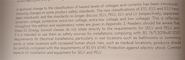

  • Can we clarify the use of Energy Source Classes 1, 2 and 3 for hazard levels of voltages and currents and the standards not discussing SELV, PELV, ELV and LV since 2020, six years ago?
    Reference IET Code of Practice In-Service Inspection and Testing of Electrical Equipment 5th Edition published 2020.

  • In what way "clarify" ?
    You refer to the IET Code of Practice for In-Service Inspection and Testing of Electrical Equipment from 2020, and will note that the prohibition on the use of sources to 414.3(iv) for certain of the Part 7 'special locations' was implemented in BS 7671:2018+A2:2022, which is a similar time-frame?
    The fact that there is no alignment with BE EN 61140 is the issue ... the products effectively use what we used to term 'limitation of discharge of energy' (although this is somewhat complicated by the use of semiconductors and doesn't fully align with 'limitation of discharge of energy' either ... but certainly neither SELV nor PELV as defined).
    I am in no way implying products to certain are dangerous per-say ... the fact is that BS EN 62368-1 only considers products for use in dry condition ... BS EN 60950-1 was no different in this regard; however, BS EN 60950-1 implemented SELV and PELV, which makes it a "horse of a different colour" when looking at supplies sourced from such products for use in certain special locations?

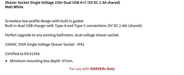

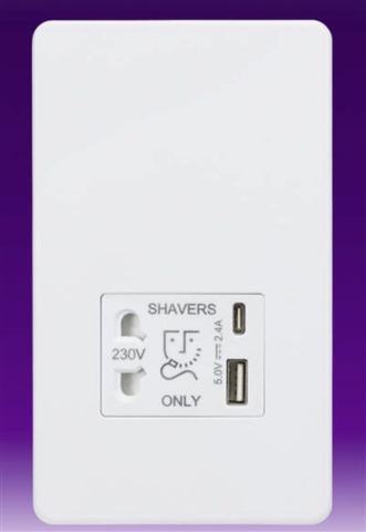

  • I will read Appendix Three of the IET Code of Practice In-Service Inspection and Testing of Electrical Equipment 5th Edition again over the weekend, as I am still trying to decide what the practical application of the guidance is regarding a fitting like this:
  • Despite having a choice of USB sockets the technical information on the website says it is only for use with shavers.
    But in reality it will be used for charging electric toothbrushes, phones, tablet computers, Bluetooth speakers and all sorts of other gizmos.
    As it stated that it complies with BS EN 61558 it appears to be suitable for installation in Zone Two, so long as direct spray is unlikely.
    But I have an image in my head of someone using a phone in the bath whilst charging it from the unit with a long USB lead, rather than using it to shave whilst standing and looking in a mirror over a wash basin.
