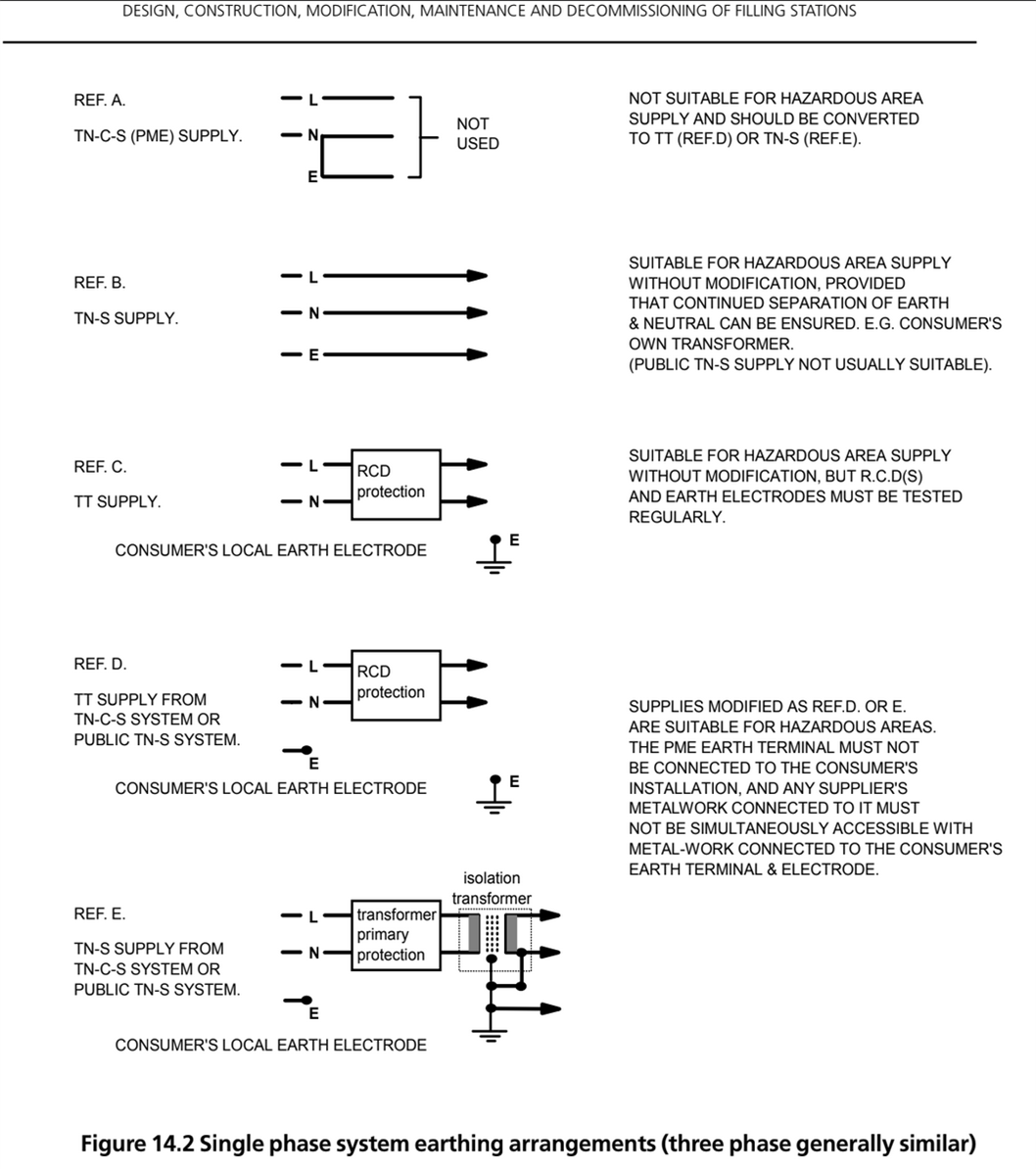

  • Here is a excerpt from APEA 'Blue Book' Guidance for Design, Construction, Maintenance and Decommissioning of  Filling Stations.
    It has a bit more detail than 60079-14.
  • I wonder if filling stations might be a bit of a special case - with the pumps being basically outdoors and lots of connections to buried metalwork there are hazards there that might not be the same for maybe an indoor situation where a decent equipotential zone could be established and perhaps diverted neutral currents avoided.

    But what I had in mind was the possibility (not applicable in all cases by any means, but  possibility for some perhaps) of being able to arrange things so diverted N currents couldn't flow through the ATEX zone - e.g. maybe some "lollypop" arrangement where there was only a single point of connection to wider earthing systems. That sort of thing would be practically impossible for a petrol station with it's undergound storage tanks and pipework, but might be possible in other situations?

    Of the just over 8000+ public fuel filling stations. I would have indicated that up until approx. 2021 none of them had their own transformer where TN-S could be guaranteed. Primary reason of course was the Max demand load wise for even a large filling station didn't require a direct substation connection. Since 2021 and the introduction of high powered EV chargers on UK filling stations then depending on the particular set up and owner of the substation DNO/IDNO then some not all of those substations will guarantee a guaranteed TN-S supply to the filling station.
    But I'm speaking about perhaps less than 200.
    The requirement for a UK filling station only to have a TT earthing system or a dedicated and guaranteed TN-S system goes as far back to 1989 and the HSE Guidance note HS(G)41.

    Your assumption is correct, majority of UK Filling stations are all TT. However the detail provided in HS(G)41 and all subsequent APEA/EI "Blue Books" indicate changing the earthing system from TNC-S or where the Public TN-S earthing arrangement could not be guaranteed wasn't to immediately condemn them and demand a change to TT. There is of course the requirement they will not obtain a full "A" classification on the annual PIR the classification will always be at least a "B" or a "C" depending on a number of factors the primary one being the measured value of the DNC. Anything more than 100mA on a earthing conductor requires investigation and risk assessment approach.
    In shared premises and old premises, converting to TT from TNC-S could actually be detrimental. We indicate that sites going under a knock down rebuild or major refurb, then yes the earthing system should be changed to TT as part of those site works.
    There is a full annexe in the "Blue Book" how this matter should be treated by electrical inspectors.
    Now your question on Instavolt etc and EVSE installed on a UK Filling Station curtilage is for the fuel filling stations emergency stop system when activated (These can be a mixture of traditional emergency stop stations at the till position to automatic interlocks with leak detection systems) will automatically "trip/activate" to open the primary protection device serving the EVSE with the preference for that interlock to be by a fibreoptic link rather than a copper cable to help prevent "Mixing" different earthing systems.
