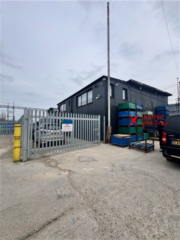

EV car parked within 2.5m of metal fence
Hi All
I've attached a photo of a proposed EV charger position that will be fitted 2.5m from the LH metal fence (which is very long and surrounds the perimeter of the compound), however the parked car will most likely be parked within 2.5m in reality.
Details/concerns are:
3 phase PME supply
The metal fence reads 55 ohms to the MET
The EV charger will have PEN protection
Bonding the fence could pose a worse situation
currents could circulate in ground
PME services underground.
Would designating the car position at 2.5m from the fence with ground painting and signage be acceptable?
Is TT the only option even though underground services could be present.
Some people have said the PEN fault protection will be acceptable and not to bond.
If the IET gods could help it would be most appreciated.
  • Just an unqualified mortal opinion, but I'd tend towards not worrying about it. In general it's only extraneous-conductive-parts within buildings that require bonding these days (if you go down the route of trying to bond everything you end up having to bond the very soil beneath your feet to create a complete equipotential zone (not impossible - buried grids can achieve that, but usually very costly and inconvenient) and even then you'd often create more problems around the perimeter of such a zone than you solve within it). Even in the days where outdoor bonding wasn't discounted there was a regulation stipulating that a metal fence within reach of a (PME bonded) steel lamp post need not be bonded - so there's some sort of precedent there too. Never say never and the regs always leave room for engineering judgement to best suit individual circumstances if you think there's a particular risk.
  • First, it depends where the fence is. If the fence is for a substation compound or similar, or an electrified railway line, then you will need to speak to the owner of the fence to determine what is safe (as it is usually part of the HV design). Similarly, if it's at a water industry site, WIMES guidance might require a particular bonding approach.
    Second, it depends if the fence is connected to exposed-conductive-parts of another electrical installation connected to a different earthing system (for example, if it has CCTV, lighting or access control equipment attached). If so, Regulation 411.3.3 applies, and 2.5 m separation from a vehicle on charge is absolutely necessary. Usually, good practice for preventing contact is the erection of a wooden fence between the metal fence and the parking space, of sufficient height to prevent simultaneous contact with both the metal fence and the vehicle.
    Finally, BS 7671 (since 2008) only requires protective bonding in buildings. If neither of the above situations exists, then it could be more dangerous to bond the fence than not bond it.
    However, I'm looking at the location in the photo... you said it would be TT, ... I therefore assume you'll be providing physical separation from the metal-clad building too, as that's almost certainly connected to exposed-conductive-parts of the PME system ?
    Most of the above is covered in the iET Code of Practice for Electric Vehicle Charging Equipment Installation.
  • Full compliance with guidance, yes, go for it, but I wonder where the risk actually sits. I doubt very much that if the EVSE was there before the fence was erected, those erecting the fence afterwards would have any regard for the issues that could arise. Indeed, it is unlikely that CCTV chaps or even the electrician fitting lights to such a fence would take it under their notice. Even the most diligent compliance with the COP can be compromised by what happens the next day.
  • If so, Regulation 411.3.3 applies, and 2.5 m separation from a vehicle on charge is absolutely necessary.
    Did you mean 411.3.1.1?
  • Hi Graham
    The metal fence thankfully does not form part of the 1st and second items above, to bond the fence would be potentially more dangerous to anybody touching the fence under fault conditions -  which could be 100-150ft away.
    The code of practice does state extraneous conductive parts connected to another earthing system so will not bond in this case and connect the Chargepoint to PME.
    Thank you for your input.
    Dean

  • If so, Regulation 411.3.3 applies, and 2.5 m separation from a vehicle on charge is absolutely necessary. Usually, good practice for preventing contact is the erection of a wooden fence between the metal fence and the parking space, of sufficient height to prevent simultaneous contact with both the metal fence and the vehicle.
    But check if a wooden fence of sufficient height would contravene local planning regulations, just to avoid those 'neighbour' disputes about high fences. Just a thought.
  • Philip,
    I can understand your thinking, but given the reason for the fence then perhaps "Wooden" fence is perhaps not the best, most screens/fences would be non combustible. Hopefully would also be considered part of the fire risk assessment carried out for the location of the EVSE and the charging bay.
