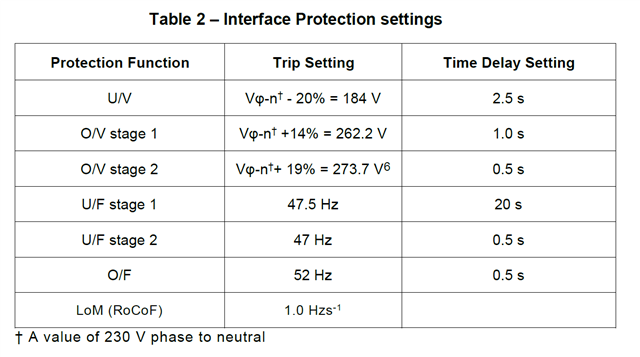

    Below from G98 Issue 2 2025:

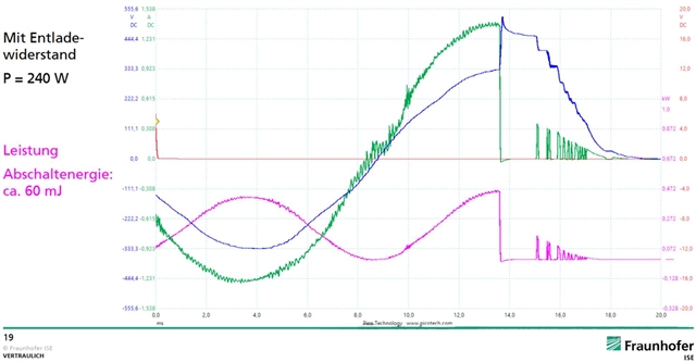

    From the German paper showing waveforms on unplugging:
    it seems that the current drops to zero just about instantaneously (green line) - perhaps a signal such as that could be used to trigger a much more prompt shutdown (or at least disconnection from the mains side).
    (edited to fix diagram)
  • It would not be hard though to add one line about plug in units  to the annex of G98 that covers loss of mains,  and make it the same as the standard for domestic and commercial equipment with a plug on it (EN IEC 62368-1:2024)  where no more  specialized standard applies.
    That would require that pins must not remain "hazardous live" above ES1 limits for longer than 2 seconds after the mains plug is withdrawn.
    Something like
    'units connected by a removable plug with accessible pins shall meet the residual voltage requirements of EN 6236801, and residual voltage be below ES1 limits within 2 seconds of removal'
    Now I've typed than in a few seconds at a cost of pence, so realistically, a joint govt and experts committee should be able to manage something similar in a few months and at a cost of millions.;-)
    In this context, depending what voltages appeared, those ES1 limits could require the voltage to fall below 60V DC or 30V RMS AC, if the available short circuit current at that time was more than 2mA DC or 0.5mA RMS AC respectively.
    This long standing requirement is one reason we have bleed resistors on filter capacitors and brakes on very large motors that otherwise generate while spinning down.

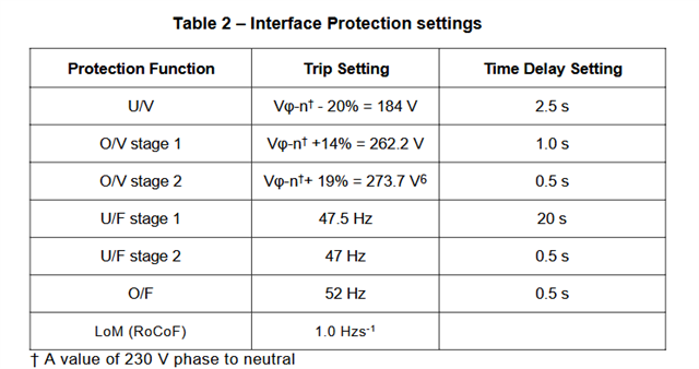

    That 2 second figure compares to G98 table 2 - while a modest under voltage should  hold on for ~ 2,5 seconds note that the thing that will operate when unplugged is the 2nd level fast under frequency detection of 0.5 seconds.  I suspect that most units will be fine with little or no adjustment.
    note that the reputable German balkony  units seem to do all this, and also claim to stop inversion within 200ms of mains loss, and to be below 60V residual voltage on the pins within 2 seconds.
    Mike.
  • That 2 second figure compares to G98 table 2 - while a modest under voltage should  hold on for ~ 2,5 seconds note that the thing that will operate when unplugged is the 2nd level fast under frequency detection of 0.5 seconds.  I suspect that most units will be fine with little or no adjustment.
    There is no time delay for RoCoF ... and this will operate if the power is completely removed.
    However, there is a delay whilst it's detected, so when we are looking at single-pole RCBOs protecting the final circuit, the inverter can continue to generate after the 40 ms disconnection time ... perhaps up to 100 ms. So, instead of max 40 ms for RCBO to disconnect, it's now 140 ms. OK for a fault to Earth in TN and TT systems, but NOT where the RCD is required to provide additional protection because someone is in direct contact with live parts (broken case of equipment, cut lawnmower lead etc.).

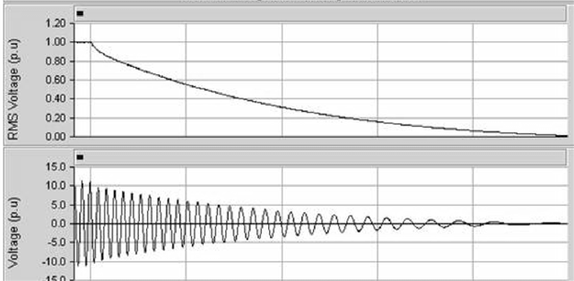

  • I take the point, but the risk to the user is not much changed as the lawnmower itself  was always allowed to hold up the voltage by generating as it spins down - that's the less than 2 seconds to less than 30V RMS. The fixed wiring is held to  a very different standard to the appliances that connect to it, in many ways actually, not just this.
    If someone is between live and true earth, having cut an extension lead plugged into the same circuit as their plug in solar, the RCD will still do its task in time. This is just yet another appliance that adds some pulse-stretching to the voltage on the disconnected side. Actually I can imagine having fully loaded washer or a tumble dryer on the same circuit as the victim may be  more problematic than a mower, as there is no deliberate braking action and stopping time maybe longer.
    In these example graphs, the power is cut at the first vertical line, after the first 2 mains cycles, and the Vertical grid-lines are 0.2 second intervals, so this whole plot shows a machine that stops generating altogether in about a second, as both voltage and frequency decay.
    Scaling the starting voltage from 230V, this example passes  below ES1 limits by 0.6-0.8 seconds. This is from a paper about designing control circuits for traditional  induction motors.  Big motors on inverters and VSDs don't behave like this of course and in any case it is all horribly variable with what else is plugged in at the same time and the impedance  reactance that is presented to the line, these are very clean plots.
