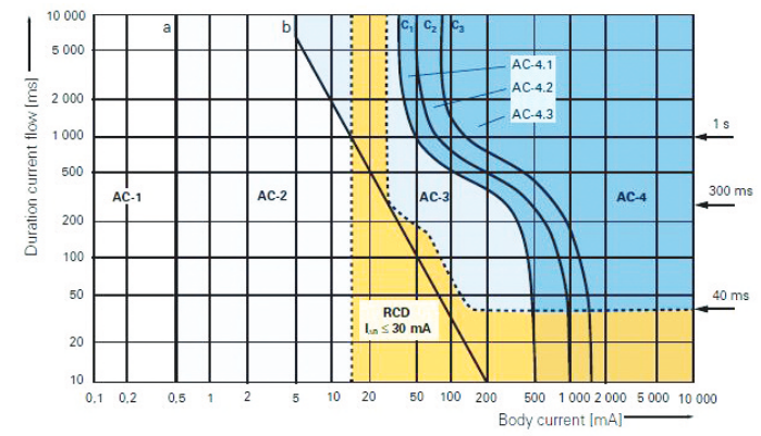

    Given the way humans are built, to avoid triggering a lethal fibrillation, you really want any high shock current to be off in about half a heartbeat period, hence the IEC curves all kinking between 100ms and just under a second .

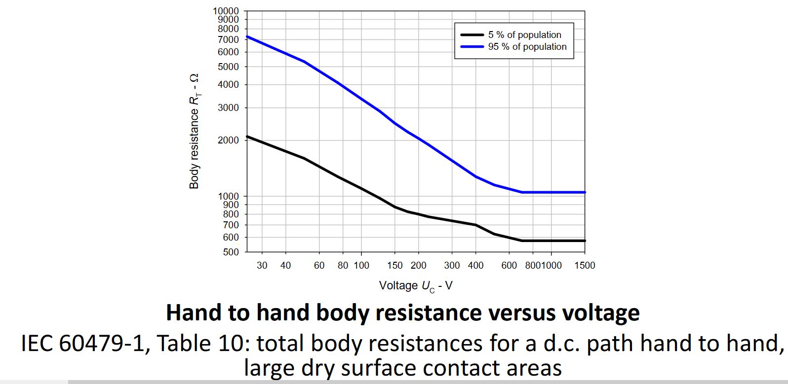

    There is a saving grace, that the initial resistance of a finger tip or even a palm's  worth of  epidermis is far higher than the one kilohm ohm figure often assumed when calculating shock current. It takes some finite time (a current dependant time) for the high resistance tissue at the point of contact to heat, char and breakdown to a lower resistance.  (its also why when you pick up the probes of a multimeter on the ohms range you get tens to low hundreds of k-ohms, and the current is low enough there is no  heating damage, so no change over a few seconds.)
    Once current flow has  established, you get the more or less standard behaviour as per the graph below.  Of course being wet or wounded so the surface resistance is bypassed, makes it all much worse.
