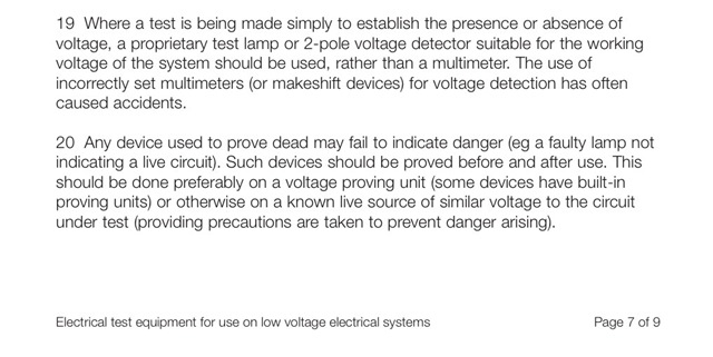

But searching online today, Martindale recommend that their AVI's and PU's do need calibrating. This has prompted me to rethink and I note that in GS38 point 30 talks about all test equipment being maintained by a competent person and one of the common errors being failing to verify correct function of illumination (eg indicator/lamp/neon).
If something were to go wrong, and it turns out the AVI and PU were not calibrated within the last 12 months, I can imagine this wording above being used to attribute blame to the person who was undertaking the proving dead.

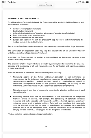

  • https://electrical.theiet.org/bs-7671-18th-edition-wiring-regulations/building-regulations/electrotechnical-assessment-specification/
    If you are an electrician registered as a Competent Person on a CPS, you are expected to be familiar with the requirements of the ELECTROTECHNICAL ASSESSMENT SPECIFICATION FOR USE BY CERTIFICATION AND REGISTRATION BODIES, which is available here on the IET website.
  • note the bit
    * Voltage indicating equipment does not require calibration.
    presumably as long as it does, broadly indicate, they are not saying it can be broken !

  • Electrical test equipment for use on low voltage electrical systems.
    Guidance Note GS38 (Fourth edition).
    https://www.hse.gov.uk/pubns/priced/gs38.pdf
  • Having an annual calibration sticker on a voltage indicator could easily breed complacency, the user may assume it is fit for purpose and not actually carry out the user tests before and after the voltage indicator is used.
  • My voltage indicators get checked every time on my proving unit, and also weekly on the main 230V supply into my garage. Yes, over my 45 year career replaced many Voltage indicators and proving units due to wear/tear and on occasion my big size 9's standing on one of them.

  • The terms "making dead" and "proving dead" possibly hail from the Electricity at Work Regulations (https://www.hse.gov.uk/pubns/priced/hsr25.pdf) - so it's convenient to use the same terms when trying to have the same meaning (otherwise you open the door much wider to lawyers to argue about interpretation).
    As others have touched on, for there to be a problem you need a situation where the indicator doesn't light up when a hazardous voltage is present - that would mean two simultaneous faults - both the indicator would need to have drifted sufficiently that it didn't light up until a significantly higher than intended and the proving unit produced a similarly inflated voltage so it looked like the inductor was working properly when it wasn't. If the two are used together fairly regularly not only would the faults need to be present at the same time, but would have to occur one pretty soon after the other (or at least in the right order) otherwise there's be a period when the proving would fail. All in all the odds seem pretty long (and probably a lot smaller than a lot of the other risks - e.g. from borrowed neutrals).
