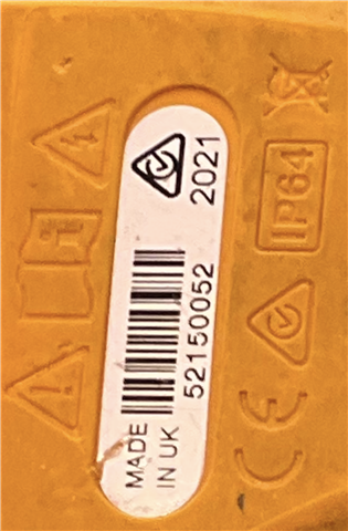

    Quote “T110, T130, and T150 T-Pole Testers shipped from Fluke after August 28th, 2018 and with serial numbers greater than those specified in the last column above are NOT impacted by this recall.”.
    So presumably the failure of the test lead sheath on this T110 made in 2021 is general wear and tear that should be identified as part of the regular user checks that should be part of the testing procedure, as the leads are deemed fit for purpose by the manufacturer?
    The test leads fail just inside the battery cover, so the battery cover needs to be removed to check the cable, in between replacing the batteries.
  • So presumably the failure of the test lead sheath on this T110 made in 2021 is general wear and tear that should be identified as part of the regular user checks that should be part of the testing procedure, as the leads are deemed fit for purpose by the manufacturer?
