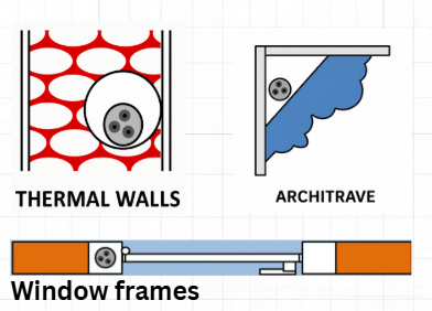

Reference Method A
Method A generally applies where cables are installed in enclosed routes or locations where heat dissipation is restricted, such as:
  • Thermally insulated walls
  • Architraves or mouldings
  • Window frames or similar enclosed routes
Because the cable is enclosed or surrounded by insulation, heat cannot escape easily, reducing its current-carrying capacity.

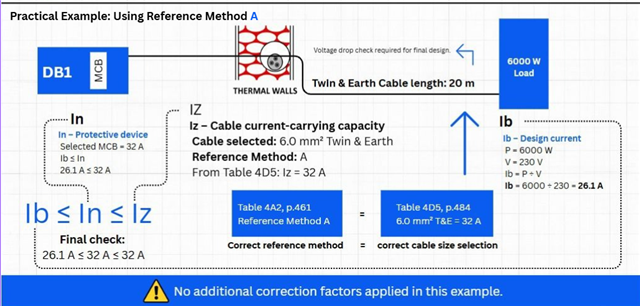

Practical example using Method A
For a 6,000 W single-phase load at 230 V:
Ib = P ÷ V
Ib = 6,000 ÷ 230 = 26.1 A
A 32 A protective device is selected.
Using the relevant BS 7671 cable table for the installation conditions, a 6 mm² Twin and Earth cable installed using Reference Method A has an example current-carrying capacity of 32 A.
The design relationship is therefore:
26.1 A ≤ 32 A ≤ 32 A
The final design must also include voltage-drop calculations, correction factors, fault protection requirements and verification of the actual installation conditions.

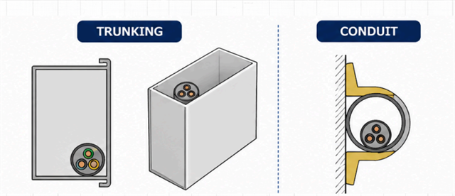

Reference Method B
Method B applies where insulated conductors or cables are installed inside an enclosure, such as:
  • Conduit
  • Trunking
  • A round or square box
Because the cable is enclosed, heat dissipation is more limited than with a clipped-direct installation.

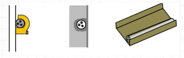

Reference Method C
Method C applies where the cable is installed in a way that generally allows better heat dissipation, including:
  • Clipped direct to a surface
  • Chased into a wall
  • Installed on a non-perforated cable tray
Because the cable is not fully enclosed in conduit or trunking, it can usually carry more current than under Methods A or B.

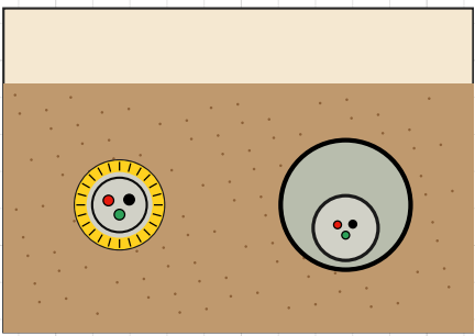

Reference Method D
Method D applies to suitable cables installed below ground, including:
  • Direct-buried SWA or armoured cable
  • Cable installed in underground ducting or conduit
  • Underground supplies to garages, outbuildings or external equipment
Method D is only the starting point for cable selection. The final design should also consider:
  • Burial depth
  • Ground temperature
  • Soil thermal conditions
  • Ducting
  • Grouping
  • Mechanical protection
  • Voltage drop

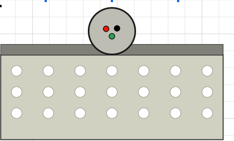

Reference Method E
Method E applies to multicore cables installed in free air, where air can circulate around the cable.
Examples include:
  • Multicore cable in free air
  • Perforated cable tray
  • Cable ladder
  • Cleated cable with suitable ventilation
The improved air circulation usually allows greater current-carrying capacity than enclosed installation methods, subject to the relevant correction factors.

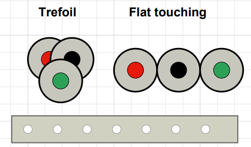

Reference Method F
Method F applies to single-core cables touching in free air.
Common arrangements include:
  • Trefoil formation
  • Flat formation with cables touching
  • Single-core cables installed on tray, ladder or cleats
Method F applies specifically where the single-core cables are touching. Where the cables are spaced apart, a different reference method may apply.

  • Method A: Enclosed in insulation, architrave or moulding
  • Method B: Installed in conduit, trunking or an enclosure
  • Method C: Clipped direct, chased in or on non-perforated tray

  • Method E: Multicore cable in free air

  • It's a nice start. Some details need some more work though I think.
    Just from a quick 1st reading...
    • Method A doesn't cover cables "surrounded" by thermal insulation - but rather it presumes heat can escape on at least one side (e.g.through the surface of the wall) - where a cable is entirely surrounded by thermal insulation (a practice to be avoided were possible) its rating could be as low as 50% of its method C rating (see reg 623.9 and Appendix 4 section 2.6).
    • Ib ≤ In ≤ Iz is only appropriate where the protective device is intended to provide overload protection and where the circuit consists of only a single cable. With UK practice that's quite often not the case - from industrial motor circuits to the domestic ring final circuit.
    • Ib = P ÷ V is only true for purely resistive loads (i.e. where the power factor is 1.0) - in many other cases the overall current can contain an element of "wattless" (or reactive) current - i.e. current that flows alternatively towards the load and then returns to the source without providing any nett power (like a capacitor alternatively charging and then discharging on each cycle). Cables need to be sized to carry the overall current, not just the power delivering bit. The more general formula additionally divides by the power factor (cos φ) (and in some cases, e.g. when working from the tube power rating of fluorescent lights, may includes an additional factor for things like control gear losses).
    • Method D has recently been split into two separate reference methods in BS 7671 - D1 (cables in buried ducts) and D2 (directly buried).
    • In the trefoil arrangement the cables touch, rather than overlap.(The red/black/green colouring also seems odd - it's reminiscent of old (pre 1970s) single phase cables - and seems especially inappropriate for trefoil as that's mostly used for 3-phase arrangements where there are advantages to be had from the effects of the three currents cancelling each other out.)
    But a good effort I think - you've certainly seem to have grasped the important principles.

  • while grouping cables together
    Good point - I missed that. I should have added that the "reference methods" are just a first approximation to the cable rating - there are a whole stack of correction factors that can increase or decrease a cable's actual rating according to more detailed circumstances. These cover a myriad of variables that give you Iz rather than just It - everything from the ambient temperature to cable grouping to different types of protective devices or even if you need to provide overload protection to an underground cable and depth of burial or soil type.
