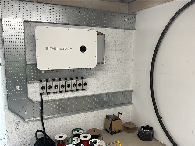

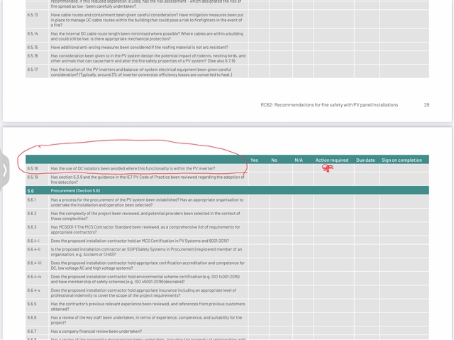

The RISC document RC62 asks installers to carefully consider the need for DC isolators. It is not unreasonable for insurers to insist that the additional risk associated with the devices is appropriately assessed. This is one of two 100Kw inverters. They are both housed in a purpose-built concrete block structure abutting a large door manufacturing plant so fire spread may be reasonably controlled. However, do we really need to have an isolator on each string. Likely done this way as it connects to the individual MPPT inputs?
Parents
  • The COP is clear that the DC switch disconnector can be built into the inverter. Therefore, there is no regulatory imperative to have individual switch disconnectors for individual string connections. You can imagine the difficulty a contractor would have if he did not have a robust design strategy that considered and controlled the risk from the devices, if a damaging fire was traced to their use.
    I acknowledge good reasons for their use and I accept that there is little substantive evidence to properly evaluate risk, but I would caution contractors and clients to avoid situations as indicated in the photo unless the insurer is consulted.

    If there are "means of isolation" in the inverter, how do you isolate the panels in the event that the inverter has to be removed?
    I cannot see how installing a row of switches could lead to liability unless it could be shown that they were installed negligently.
    ETA: it makes a change to see good workmanship. :-)
  • A sensible engineering decision cannot be made without data - so does anyone know where all these fires from DC isolators were, and what was the cause?
    If it is the misuse of AC contacts on DC circuits, or breaking under-load using devices designed only to isolate when off-load, or overload due to inadequate current ratings, then  there is a need for better educational material and/or tighter product standards. The man on the ground acting as designer-installer is not well placed to make the decision in a vacuum.
    Advice to take reasonable steps to avoid without context is unhelpful.
    There is a general problem, that except at night or when covered, solar panels cannot be turned off, and unplugging things while still energised is not without risk, especially in large systems using higher voltage strings near the kV level.
    The inability to isolate must be balanced against the risk of the isolator causing an extra problem.
