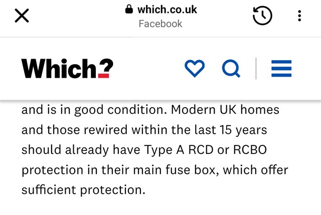

  • "homes with Type AC RCDs should not use plug-in solar systems without first upgrading"
    which seems to leave homes with no RCDs at all without any constraint ... which seems a little inconsistent.
    Just read the electrical safety first document.
    https://www.electricalsafetyfirst.org.uk/safety-advice/products-and-appliances/green-energy/plug-in-solar-panels/
      It says
    "we recommend households have at least a Type A bidirectional RCD protecting circuits intended for use with plug-in solar panels. Until these concerns are addressed, homes with Type AC RCDs should not use plug-in solar systems without first upgrading to a minimum Type A bidirectional RCD on those circuits."
    To me the type AC bit is just reinforcing that type AC RCD's are not acceptable, not that a consumer will be able to identify which they have.
    Which is fairly clear guidance and NICEIC have said they support the statement, I can't find anything from NAPIT other than their response to the consultation.
    So there is some documentation I can quote if I have to defend guidance I am giving. But no doubt going by the continuing divergence between NICEIC, NAPIT, IET, Electrical safety first on other issues they will come out with statements that are slightly but critically different over the next couple of months.
  • As seen on Facebook, Type A RCDs have been installed in the UK for the last fifteen years according to the Which magazine journalist.
