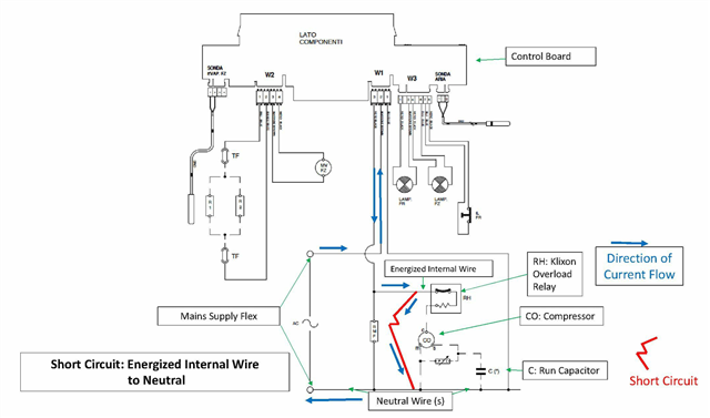

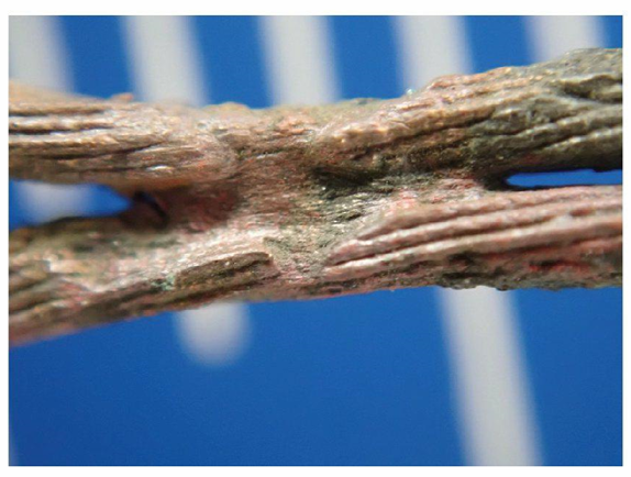

    Mike, Graham, thank you for the links.
    I am struggling a bit with the addendum to Dr Glover's report.
    Figure 7 shown a L-N fault.
    Figure 5 shows what appear to be two multi-strand conductors which have fused together due to an arc. They could have been at line and neutral potential respectively.
    I agree that such an event could have tripped the MCB of circuit 7. However, I am troubled by the explanation for the RCD tripping.
    Smoke and smoke particles (soot) are electrically conductive. When smoke and smoke particles attack an electrical socket, the socket receivers can be affected by deposition of soot. After the 32-A MCB for Circuit No.7 tripped and prior to Mr. Kebede turning off the Main Switch at the Consumer Unit, Circuit No.8-Flat Sockets (not including those in the kitchen) as well as the RCCB remained energized. It is probable that smoke and smoke particles, having exited the kitchen before Ms. Kinfu vacated Flat 16 and before Mr. Kebede turned off the Main Switch, attacked an energized socket resulting in a current flow to the grounding socket receiver in excess of thirty milliamperes (30mA), which tripped the RCCB.
    How did so much soot enter a socket? How did it get behind the shutters?
    Then we have:
    Mr. Kebede states, however, that when he left his flat, the smoke had not spread beyond his kitchen [Paragraph 76, IWS00000490].
    But he had opened the main switch. So there is an important inconsistency here.
    Then we have in (paper) page 516 of the report which Mike linked, In my view it is better to accept that it is not possible within the scope of this Inquiry to identify with confidence the precise nature of the defect in the large fridge-freezer which caused the fire.
    The real issue was to do with the cladding.
    I have to say, with the assistance of Occam's razor, that there had to be a L-E fault in the fridge-freezer, and it tripped both the MCB and the RCD.
    It follows that an AFDD would have added nothing.
