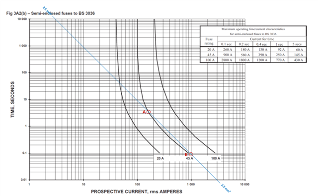

    For fuses, and in the thermal range of circuit-breakers, this is done for a selected cpc size by plotting the line corresponding  t=k2×S2/I2 over the time-current characteristic in Appendix 3, and checking that, for the range of prospective fault currents expected in the circuit, the line plotted is above and to the right of the fuse time-for-current line. In the example below, the two points where the fuse time-current line crosses the adiabatic line (2.5 sq mm) show that, provided the prospective fault current along the length of the cable is between around 130 A and around 1000 A, the adiabatic criterion is satisfied for a 45 A BS 3036 fuse and a 2.5 sq mm copper CPC:
    Hence, provided the prospective fault current exceeds 130 A at the far end of the cable, and is less than 1000 A at the consumer unit, everything is OK for that combination.
    Therefore, as   and  have said, in practice for fuses and in the thermal region of circuit-breakers, checking the adiabatic criterion is satisfied at the end closest to the distribution board, and the end of the circuit furthest away from the circuit board does the trick.

  • fuses, and in the thermal range of circuit-breakers, this is done for a selected cpc size by plotting the line corresponding  t=k2×S2×I2 over
    Well, with the risk of sounding like an over eager schoolboy keen to impress with a shooting hand a loud please sir, since we are being pedantic, the I squared is a divisor!
  • Absolutely correct.
    t=k2×S2/I2
    I have edited the previous post accordingly.
