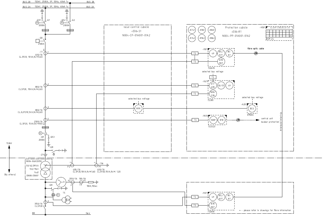

 This is an issue I've noticed all across Iraq, but I'll give you an example that I'm currently working on. We have a 132/11 kV YNd1 transformer, the primary is fed from a GIS, and secondary has a Zigzag NET with NER and a CT on the neutral point. this CT is used for REF protection.
 when we operated this transformer frequent tripping happens due to REF protection, some people say that this is due to grid instability and frequent voltage variation, others say that it's related to the current entering the neutral point due to instability. I'm not convinced by those claims and I think there's a deeper issue or reason.
 Please note that this is common around Iraq, so it might be related to the grid (in some places REF is disabled), but what I want to know is the reason behind this phenomenon.
  • HV is way outside of my comfort zone, so I probably can't be much practical help, but if I may ask a few silly question (which might even help the discussion along a bit)...
    Is this a conventional setup with the 132V side feeding the 11kV side? (i.e. conventional loads on the 11kV side, rather than backfeeding from an 11kV generator or anything like that)
    How is the transformer wired? As I read the diagram it looks to be delta on the 11kV side and star on the 132kV side - which looks the opposite way around from what I think usually happens in the UK. Is the REF CT (and NER) then between an "artificial N" point and Earth?
    sorry for the dumb questions

  • I assume that, as well as checking for actual faults, you have verified the relay settings and any shunt / stabilising resistance required for the scheme according to the network, equipment and conditions. After a nuisance trip I would make sure to check both the calculated settings and what's actually been applied (has someone mis-set or nudged a variable resistor, for example).
    Pedantry I think, but it looks like the REF is only operating on the N-E link. I presume in practice the relay has actually got the phase CTs also (it appears the relay itself has but I don't know the device and it may be a separate input)
    The REF CTs appear to be merely 5P20. As a minimum I would normally expect class PX with a defined knee point Ukp and DC resistance Rc, although on this scale I would probably also insist that all four in a set were the same make & model, or at least pay close attention to the IV curves. It may be then that the CTs are not sufficiently linear, particularly on through-faults or other out-of-zone events, causing them to operate.
    The CTs look to be single ratio but multi-tap is common. Could you have been supplied CTs with two taps without knowing and have one or more on the wrong tap? Have seen that before due to a mistake at the marshalling box.
    Is the nuisance tripping coincident with other network operations e.g. energisation of transformers elsewhere? It may be worth seeing whether your device has inrush harmonic blocking available.
    There aren't any shown on the SLD, but I assume that no-ones been clever and swapped the earthing transformer for one with an auxiliary winding for substation loads.
  • Check the relay settings (What's it current settings, try to increase and recheck transformer operation). Also check stabilizing resistor value and settings if REF is high impedance.

  • Hi Mustafa
    Not my specialist subject but I read from the Network Protection and Automation Guide (available to download *) that the delta winding  /earthing transformer arrangement will cause unwanted relay operation.
    16.10 COMBINED DIFFERENTIAL AND RESTRICTED EARTH FAULT SCHEMES
    Section 16.10.1 Application [When an Earthing Transformer is Connected Within the Protected Zone
    A delta-connected winding cannot deliver any zero sequence current to an earth fault on the connected system, any current that does flow is in consequence of an earthed neutral elsewhere on the system and will have a 2-1-1 pattern of current distribution between phases. When the transformer in question represents a major power feed, the system may be earthed at that point by an earthing transformer or earthing reactor. They are frequently connected to the system, close to the main supply transformer and within the transformer protection zone. Zero sequence current that flows through the earthing transformer during system earth faults will flow through the line current transformers on this side, and, without an equivalent current in the balancing current transformers, will cause unwanted operation of the relays.
    The problem can be overcome by subtracting the appropriate component of current from the main CT output. [ continues]
