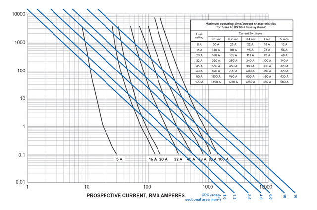

    For example, suppose the design calculation assumes at the remote end of a circuit:
    ZL−N=0.5ΩZ_{L-N}=0.5\OmegaZL−N​=0.5Ω
    which, simplistically at 230 V, gives:
    If=2300.5=460AI_f=\frac{230}{0.5}=460AIf​=0.5230​=460A
    The designer's software uses the resulting fault current and the appropriate protective-device data to establish that the conductors remain adequately protected.
    Now suppose the completed circuit has an actual L-N impedance of:
    ZL−N=1.5ΩZ_{L-N}=1.5\OmegaZL−N​=1.5Ω
    The available L-N fault current is then only:
    If=2301.5=153AI_f=\frac{230}{1.5}=153AIf​=1.5230​=153A
    The OCPD may now be operating at a quite different point on its time/current characteristic. If that moves the device out of its instantaneous region, the reduction in fault current could result in a substantially increased operating time.
    I am not saying that 153 A necessarily means the conductor fails the Chapter 43 requirement. That would require assessment using the particular protective-device and conductor data.
