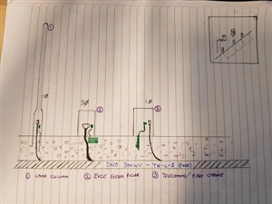

    Hi Graham,
    I've done a quick drawing on a typical site to help explain what I'm proposing, and what would essentially happen is that you could install a link between all three METs, this would also increase the surface area of the copper earthing rods/mats and overall reducing the Ze. This would require the permissions of those who own/maintain the adjacent equipment to allow the earthing systems to be combined and also the installation of a label/notice, similar to the standard "Safety electrical connection, DO NOT REMOVE", maybe "This earthing system is interconnected with adjacent equipment - Do not remove", the furniture this is connected to could be confirmed by performing an R2 test with a wandering lead.
    This would reduce the danger of having a potential between items and create a lower path of resistance to earth that the safety mechanisms of ADS and additional protection would be able to activate in an even shorter amount of time.
    It seems like a very particular situation but in many streets and side roads, there is frequently only one supply cable which would make this possible, if the other installations weren't TT, then it may be possible to convert them to TT with the owners permission or to have them converted by the owner themselves. Wouldn't this remove the need for the required  2.5m between items? I admit, there are many "if"s involved, but we need to have a sensible method of being able to install the EVCE before it becomes impossible due to adjacent street furniture.
    If I've overlooked something, please let me know and I can have a look at different ways around the issue.
  • In practice, this is no sillier than a pair semi-detached cottages with TT supplies, each with a bond to a metal water main that effectively interconnects them. As such it is not especially dangerous, and may actually make things safer. However, I think the letter of BS7671 is that pairs of TT systems with different origins (and the origins would be the company fuses) are to be treated no different in terms of segregation rules to any other system, and the fact they share a substation is ignored.
    From first principles, I'm inclined to agree with you, as a credible fault that could make anything live for longer than an RCD tripping time is not likely; but the rules as currently written are against that interpretation.
