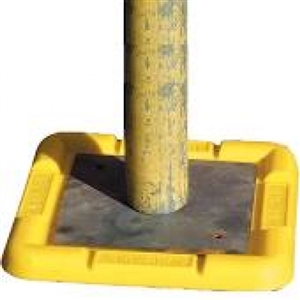

  • That is a good point, though no known HV lines in this case. I suppose rubber pads and non-skid feet, and the tendency to use shims of wood to make up levels mean that scaffolding may often be electrically floating and free to pick up an arbitrary voltage. In this specific case the metal scaff has been checked and  is at or very near terra-firma earth voltage, but experience on other sites may explain the scaffolder's apparently rather "gung-ho" attitude.
    round here these things
    and the big screw up jacklegs seem pretty common, and I'd expect that arrangement to be pretty insulating. I;d be rather less sure of the C to ground, perhaps I need to sneak out and measure one when it is not raining
