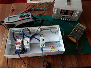

  • Today I aim to measure an RCD or two to determine the DC characteristics. I have nothing else which I can do as am confined to the house, and will attempt to plot the DC sensitivity of any RCDs I can find lying about. I don't think I have a B type, but a number of A types should be fairly easy with a lab constant current supply and my MFT. I will report on the findings later.

    I have tested one 30 mA so far. The results are interesting, particularly that I couldn't make it work on a 250W isolating TX with TN-S output at all, PFCC 16A. So a bit of wiring to give me a non-RCD protected 13A socket, and things got better. I used a Megger MFT 1552 tester which gives 4 options for the delta In test, 0, 180 degrees and +,- DC. I used a lab supply with CC output strainght across the N of the RCD, no Rs and Cs for me! DC current measured with a Fluke multimeter as below the PSU meter resolution. The RCD (I will not reveal the make yet) was brand new supplied in a 18th ed metal CU. First test at 0 DC although all the equipment connected gave (30 mA ramp) AC 0 12ms, AC 180 7.6ms,DC + 18ms and DC - 7.5ms. So all passed with flying colours, trip times about 20ms at 30 mA all round. 10 MA of DC changed the AC 180 to 21 mA and DC+ to 12 mA,Others much the same, but results very  repeatable. 20mA DC not much change. 30 mA DC stopped AC trip altogether (both phases) and DC-, but DC plus still tripped at 18ms.
    Next change to 5 delta In (150 mA). Here up to 100 mA of DC made little change on AC test, I haven't done DC yet as SWMBO is wanting a hedge trimmed! I will look out some others to see what they do, but not exactly as expected for a EN61008-1 RCCB (80A).
  • This is the setup

    I am surprised that a Type AC will still trip at 150mA with a 100mA of DC injected. I will have a go at measuring the DC injection on my old Robin 4120DL loop tester. It locks up RCDs but not RCBOs. It would suggest that RCBOs have a higher DC immunity than RCDs. My DC clamp meter only goes down to 100mA so my test may not indicate anything.
  • I can confirm that a 200 mA DC current can trip most types of RCD, just try doing a R1+R2 test with a RCD in the circuit ?
