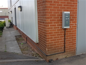

  • Sparkingchip:
    I stand looking at installations and end up up with so many questions in my head.
    A block of five units presumably with five electrical intakes, now walls have been knocked through and five have become two.
    Steel frames, steel cladding, steel roller shutter and steel personnel doors mounted into the other steel work, air conditioning units mounted externally on walls and floor standing on some slabs as
     in the photo.
    The EV charger has been installed as TT, so presumably the main installation is PME.
    Given the location of the rod immediately adjacent to the building and everything else that is going on in the photo was it worth doing so?

    That's very interesting ... how is the TT installation immediately adjacent to the PME supplied installation separated from the PME earthing system?
    For us, the issue would be two or more PME services into different areas of a steel building. It would be possible for the steelwork of the building to carry diverted neutral currents, for which it almost certainly would not be rated.

    That I understand.
    However, connecting extraneous-conductive-parts to the MET (or inadequate separation of the TT earthing system) effectively connects the installation to PME, This may cause a problem for either diverted Neutral currents in the LV system as before (the TT earth electrode resistance may be very small, and if not properly separated ... it's pretty much connected?). Also, the issue I pointed out previously.
  • If the answer is "it doesn't matter" (from the DNO perspective), and the TT earthing arrangement is not properly separated, then we are in a tricky situation in cases where the PME earthing system is not connected to the HV earthing system at the supply transformer, as the statement Uf = 0 in Table 44.1 of BS 7671 is no longer always true !
    Do you mean when the PME system is connected to the HV earth? (the situation then becoming similar to the first of the TN rows of 44.1 & Uf might be as high as RE x IE during a HV fault). Even so is there a practical difficulty? We generally construct TT installation using the same materials as a TN system and if a TN system can withstand RE x IE why should we expect a  problem with a TT system?

    The importance of this relates to Regulation 442.2.1 (in this case, if you are one of the TT consumers, you are having to rely on an additional earth electrode in someone else's installation - so how can the designer ensure BS 7671 is complied with), the effectiveness of the chosen method of connection of surge protection, and potentially the insulation coordination of  switchgear etc
  • The importance of this relates to Regulation 442.2.1 (in this case, if you are one of the TT consumers, you are having to rely on an additional earth electrode in someone else's installation - so how can the designer ensure BS 7671 is complied with)
    As I see it, if it was a pure TT system there wouldn't be an issue (Uf would be zero). The problem comes from the influence of the PME earthing system supplying another unit - but that PME earth itself presumably satisfies the requirements of 442.2.1 (presumably by some approximation to a 'global earthing system') - so I'm thinking that if the PME earth in the other unit is deemed safe, then it's influence in our TT unit can't be any more dangerous.
